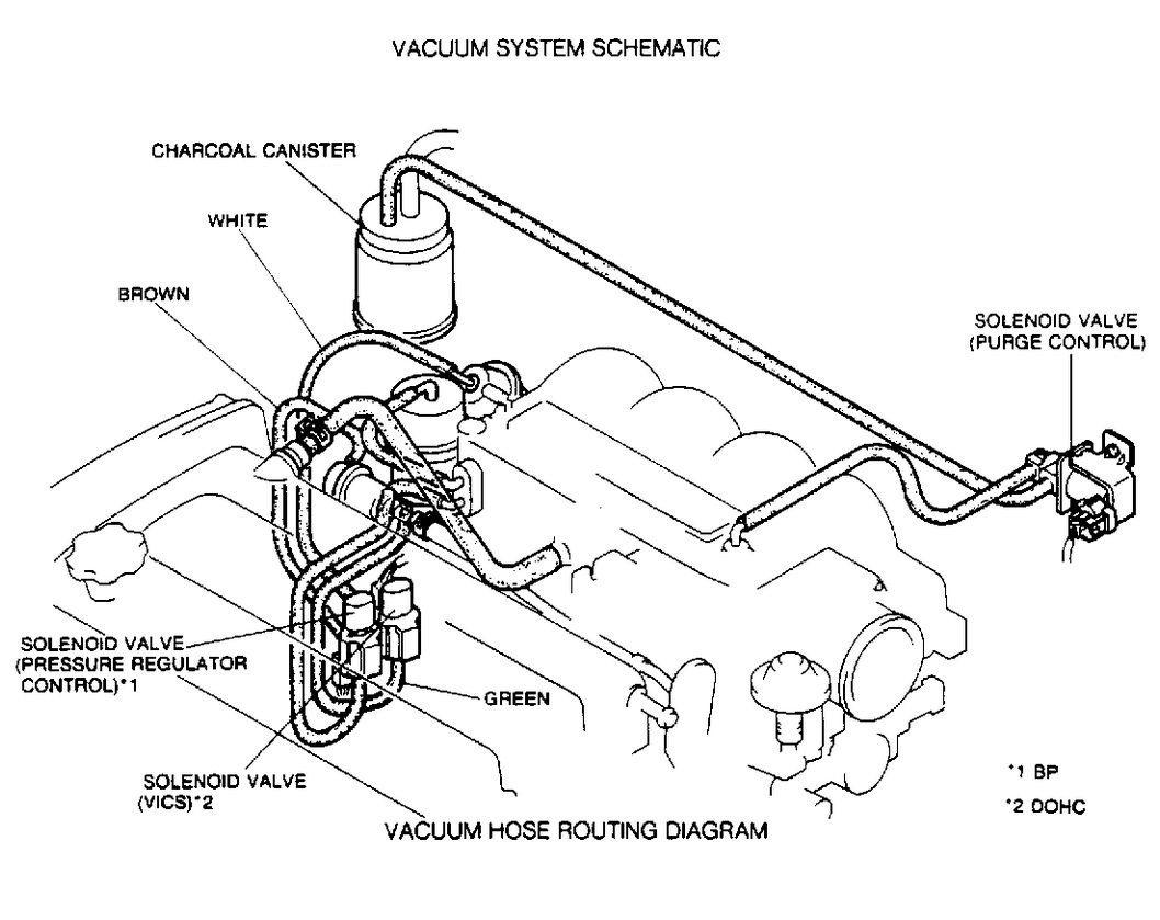

Some of the vacuum hoses were cut and some missing. Does any one know where I can find a diagram?

That is shown on the vacuum hose routing diagram on the emissions sticker under the hood.

Try this.
