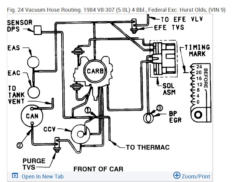

Looking for a clear diagram that shows placement of vacuum hoses. The original hoses are missing for the EGR valve. Need to re-route the hoses.
Vacuum Hose Diagram Vin Y 4 BBL Auto Trans All Models Federal

There is a printout of the vacuum schematic in my manual that I attached below. Take a look through it and let me know if it helps.
See pic below.
