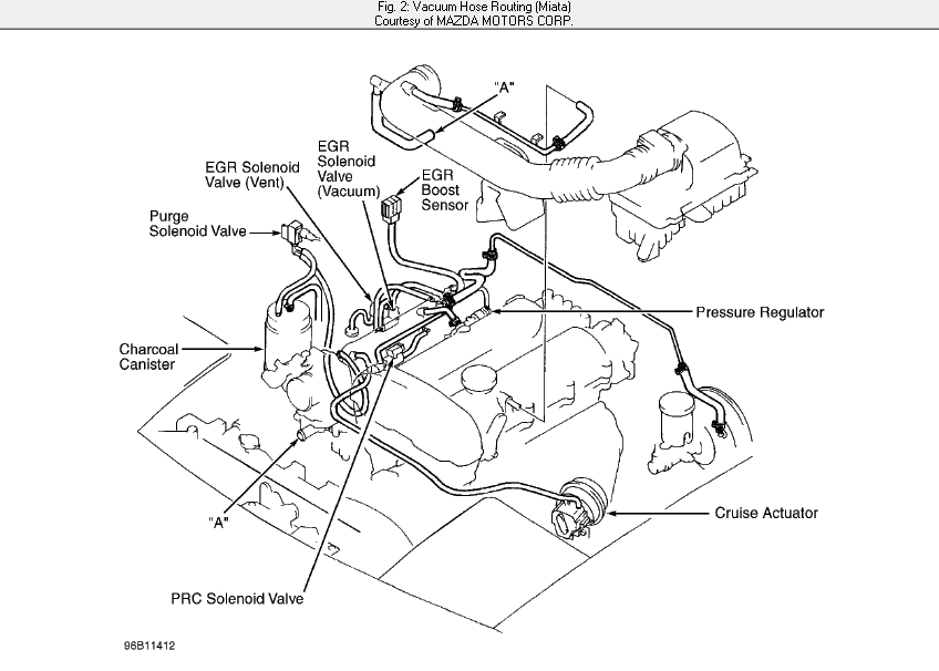

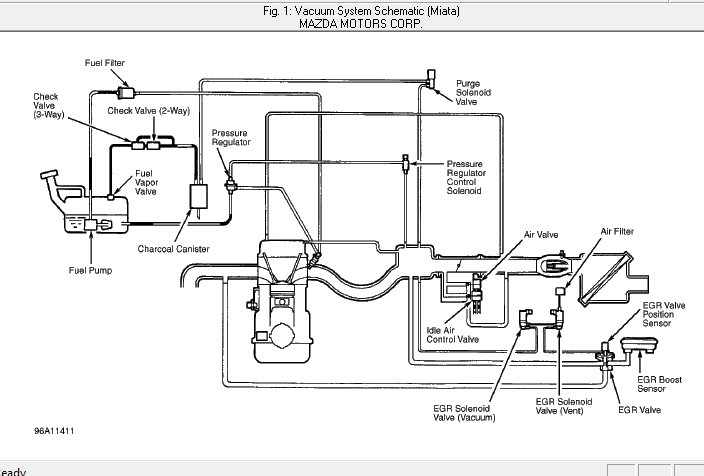

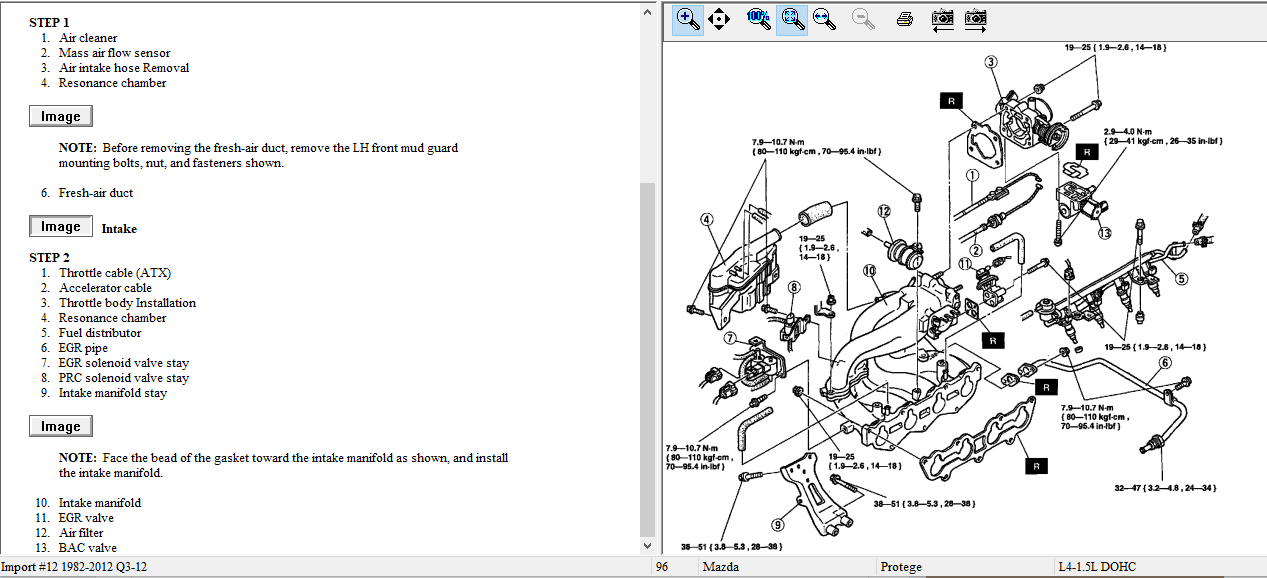

vacuum hose diagram that i found is for mazda miata fig 1 and fig 2 after my research miata and protege they use the same engine. check fig 3 for protege mazda, hope it helps.
let us know if you need more help.
