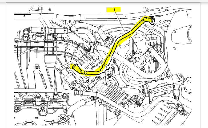

I am prepared to do a pressure test on my vacuum lines looking for a leak. I'm not sure where all the vacuum lines are located. Could you please provide me with diagram(s) to show me all the lines to be checked and located. I'm using a vacuum pump tester and brake/steering fluid bleeder for these tests.

Yes, you shared that with me before thanks. It would be great if I knew where the corresponding components are located on my car. I don't know what is or isn't a vacuum line or is a vacuum line. I've searched the web and the cars they always show are set up totally different, so again I don't know where to spray carb cleaner. I know where the head gasket and such is but the whole vacuum system is a mystery to me.

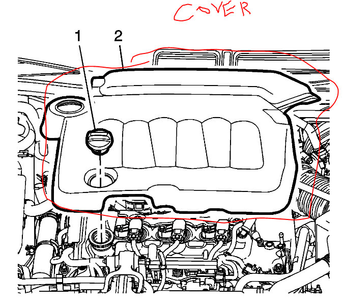

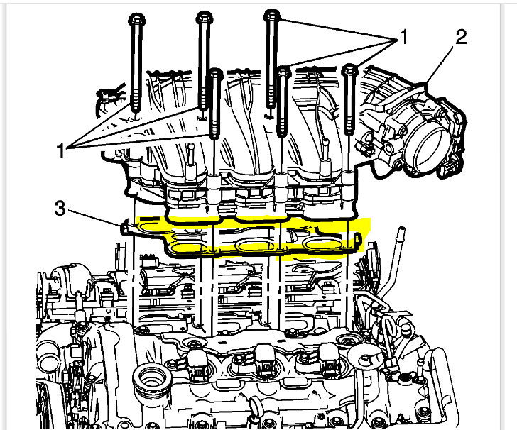

Could you find a pic or a few of my engine and circle or highlight where the certain sensors and places where vacuum lines would be and where I should spray the carb cleaner. That would be super helpful. thanks

In pic 1, you will see the cover at the top of the engine. Remove the oil cap and gently pull up on the cover to remove it. Then replace the cap.

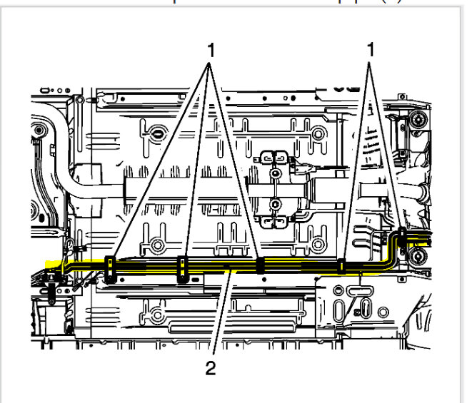

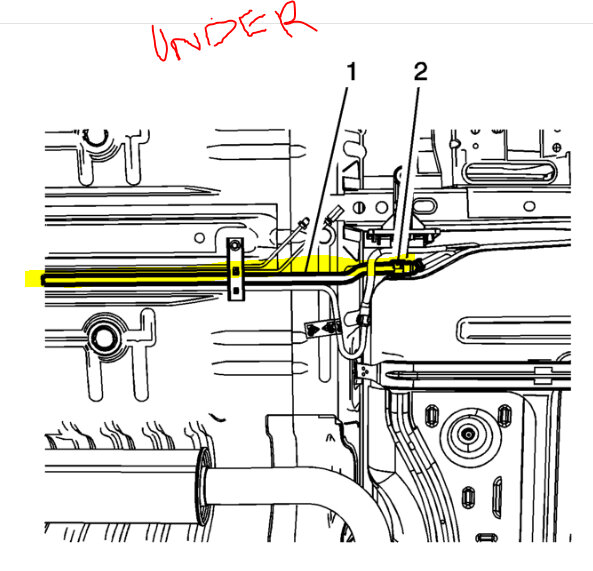

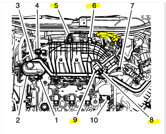

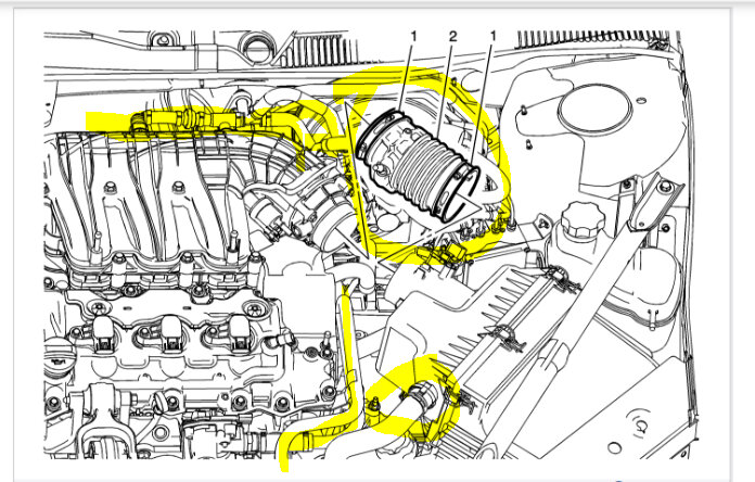

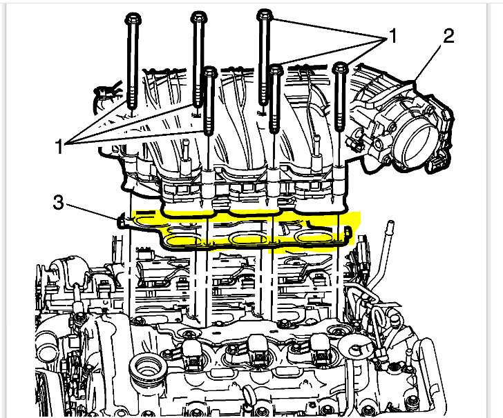

Pics 2, 4, and 5 show some of the general vacuum hoses. Pic 3 is an exploded view of the intake manifold being removed. Spray around where the manifold and engine block are bolted together. The last two pics show the EVAP hoses that run from the rear of the vehicle (fuel tank/Charcoal canister) to the engine compartment.
When you do this, be careful not to spray carb cleaner directly on extremely hot components such as the exhaust manifold, catalytic converters, or exhaust system. There is a risk of fire, so be careful and do it when the engine is cold and just started in areas with little access.
