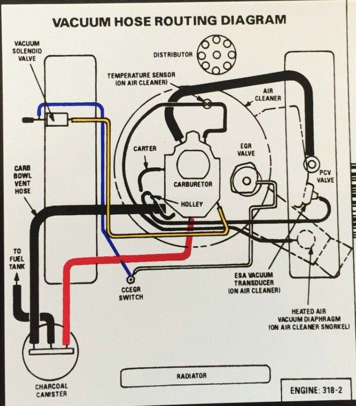

Need a complete vacuum hose diagram please.

I went through my schematics and because of the model year, there was no information. I was able to find the vacuum schematic for a 1974 5.2L Challenger. Take a look at it and let me know if it helps. Also, let me know if you have specific questions.
See pic below.
