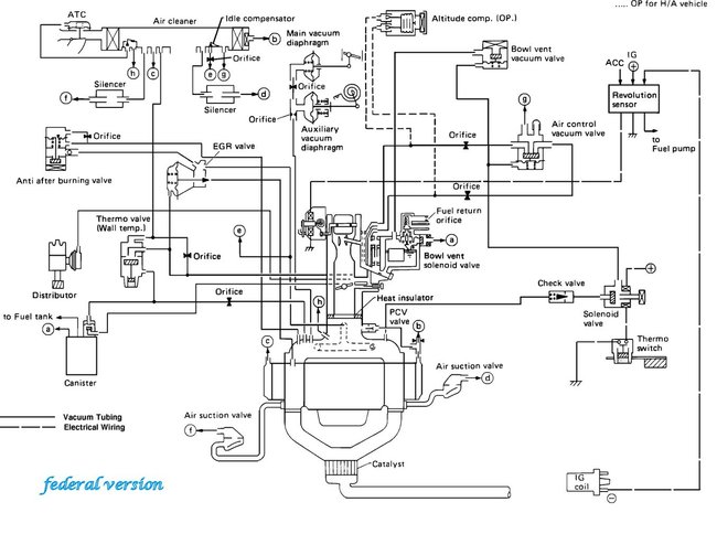

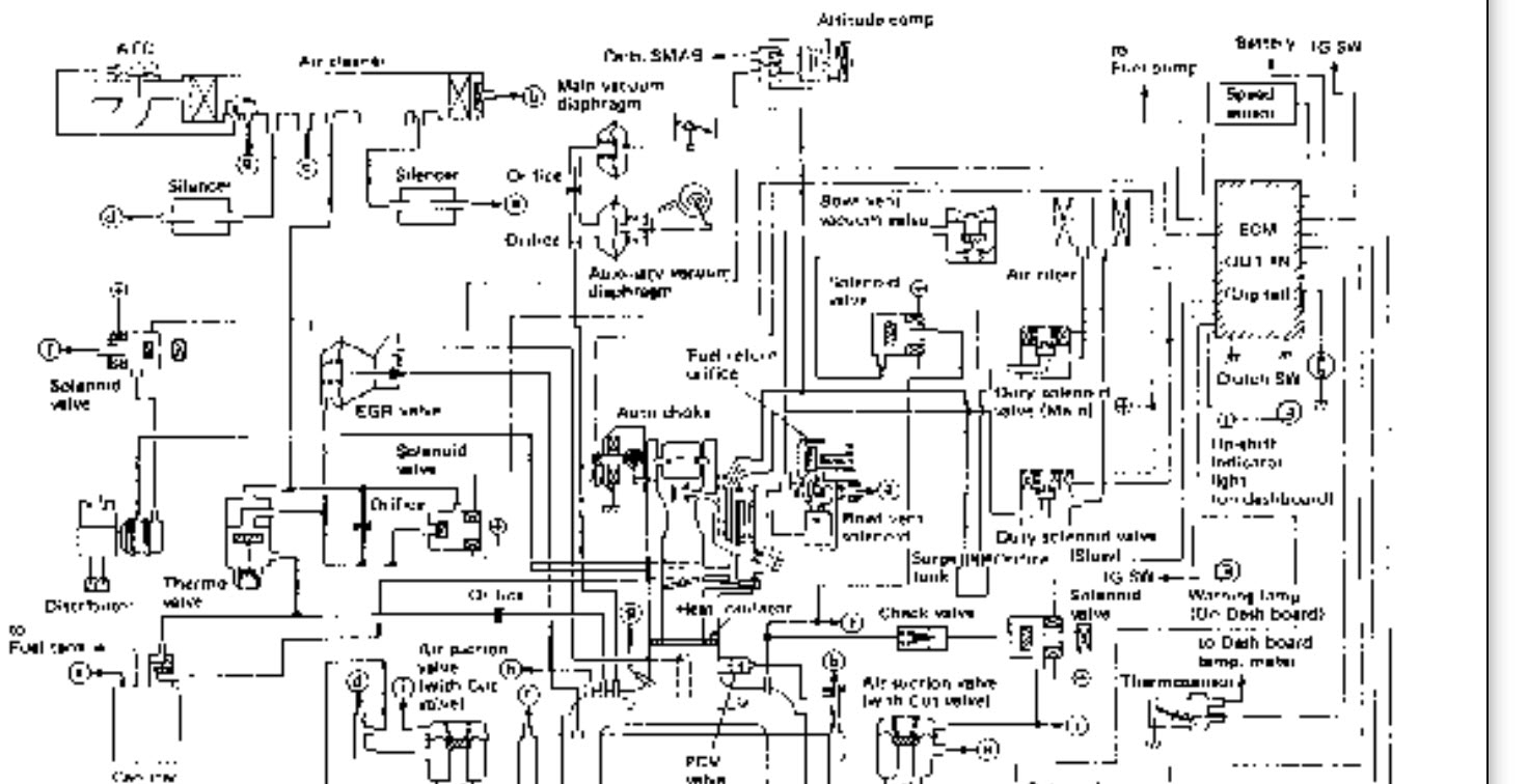

I have the car listed above and I got it the carbon was off and no idea where the hoses go.
Dec 18, 2016 at 4:14 AM
HMAC300
  • 48,601 POSTS

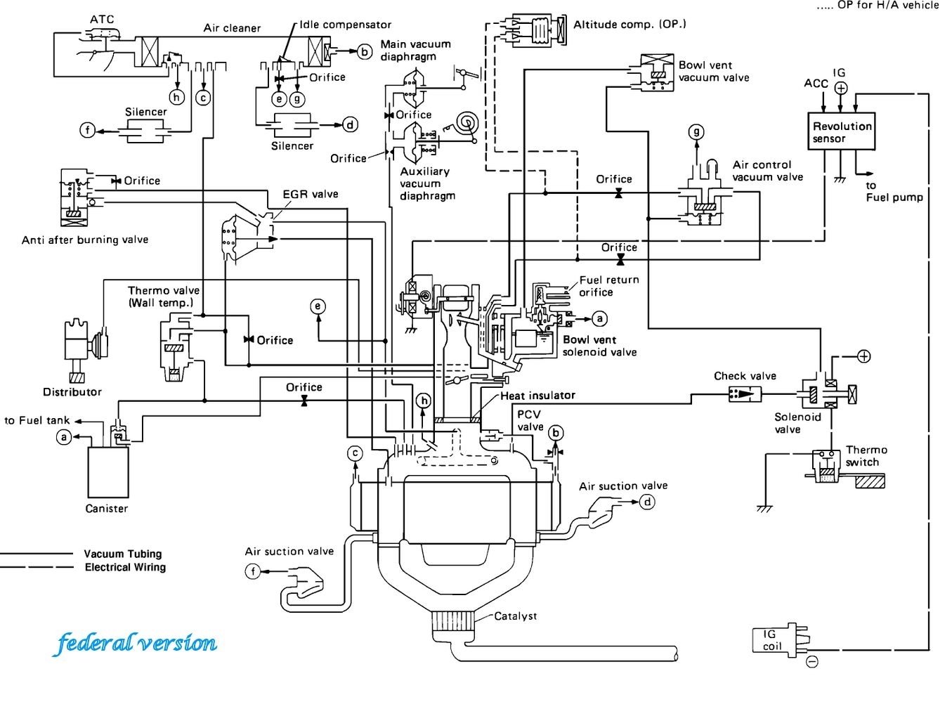

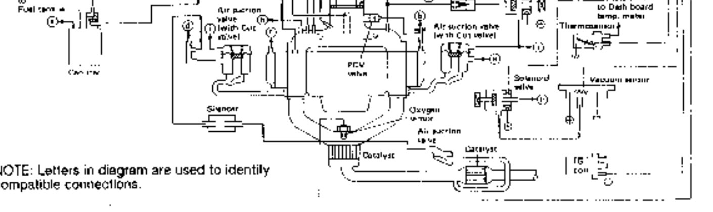

see pictures. diagram is not very good at all, but it is all that we have this is for four wheel drive. if turbo fuel injected it is different.
Dec 18, 2016 at 8:29 AM
STEVE W.
  • 15,200 POSTS

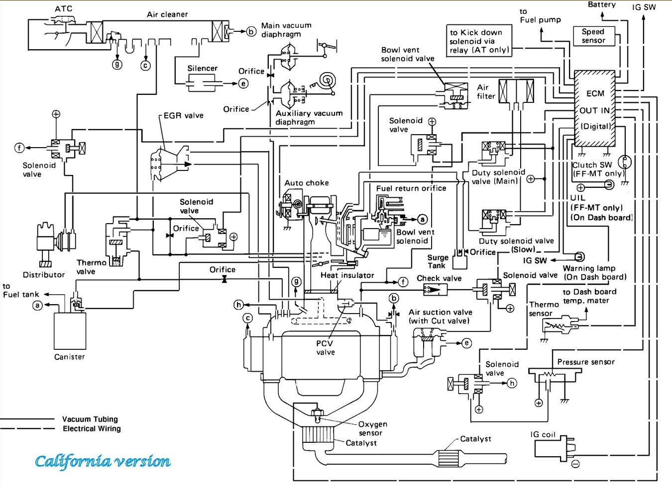

Here are the California and federal versions. Good luck.
