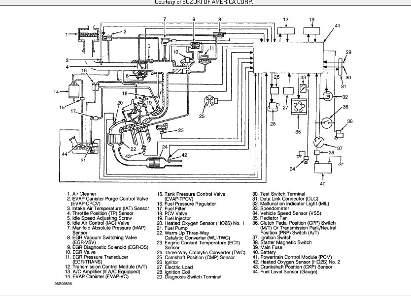

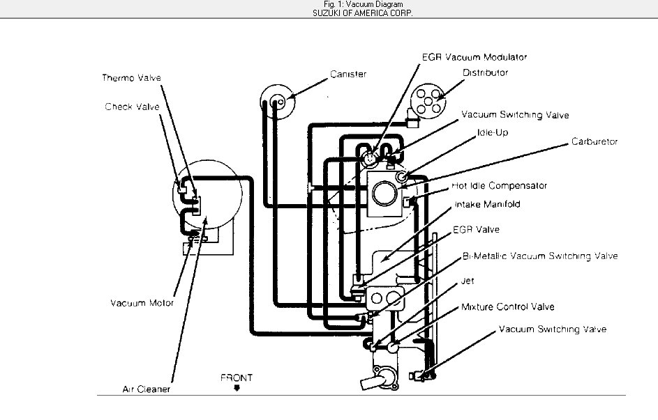

When I received my car from service station, I noticed couple of vacuum hose were swapped and the one connecting between carburetor and distributor (for vacuum advancer) is missing. I didn't get any solution from them. I need the factory default hose connection details.

Check the diagram below for vacuum system of your engine. Check out the diagrams (Below). Let us know what happens and please upload pictures or videos of the problem.

The diagram you sent is for the next version with MPFI.
But the one I requested is for old carburetor type.

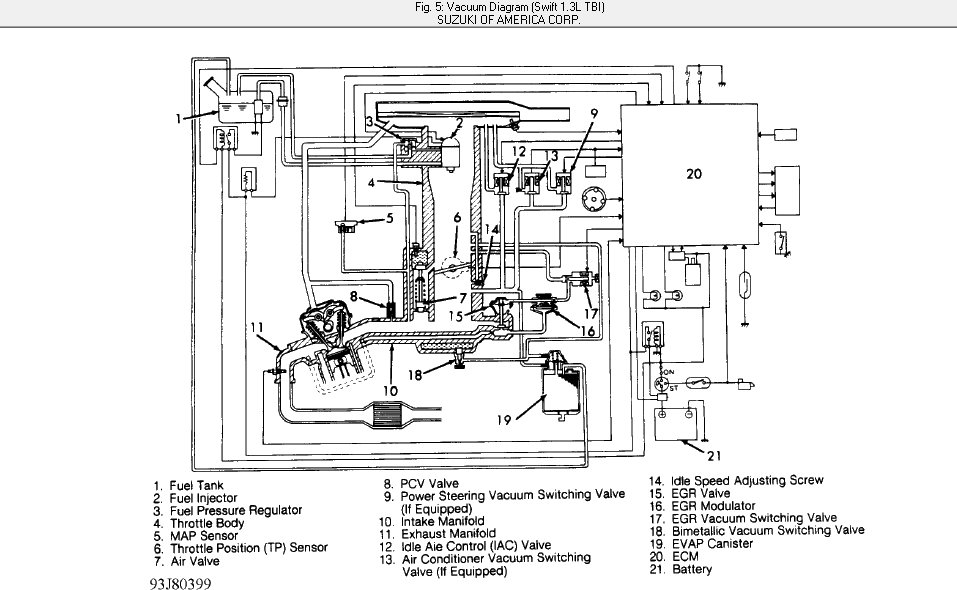

i check suzuki catalogue 1996 esteem all have mono injector system they share the same engine with the swift check the diagram below figure 1.

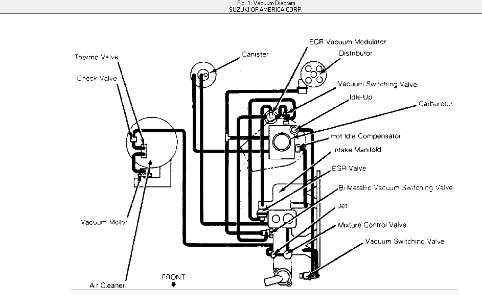

below model years 1990 i found carbureted engines check figure 2 below for vacuum diagram.
hope these helps.
