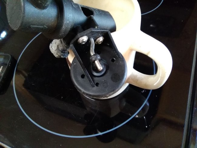

Have replaced this valve three times in last year. Cannot go through winter losing antifreeze. This valve is leaking where the rod connects to something on the valve. There is a piece where rod connects that if you put finger on it you can feel water dripping out. I have replaced this three times and all three have leaked. valve is four port. I have no idea why it keeps leaking. Anyone has had any experience with this and knows because I am all ears. Like I said I cannot afford antifreeze and do not need to add to pollution.
Any help is greatly appreciated. Thanks, Dennis

What brand and part number valve are you replacing it with?

one was Motorcraft and two other were off brands. I do not remember names purchased off of Rockauto.

I am starting to think it is not the valve but the hoses and clamps you are using, can you take a quick picture of the problem so we can see? Upload it here

Are you reusing any spring loaded hose clamps to install the valve?

yes 2 of the hoses have "spring loaded" 2 others i replaced with screw type

Is it leaking over where your reusing the spring loaded clamps by chance?I don't reuse the spring loaded clamps have had bad luck doing that.

It's not the hoses. It's running out where metal arm is connected in picture.this is4th one in yr. This was is "carquest" although it looks like same mfg.of last 3. See how long this lasts. Trying to get a motorcraft one but it's like pulling teeth. around here.. thanks

Yep you are going to need to cheap automotive replacement parts don't last as you can see.

Rock auto dot com has the motorcraft one it's 19 plus shipping.
