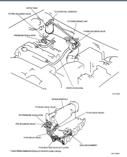

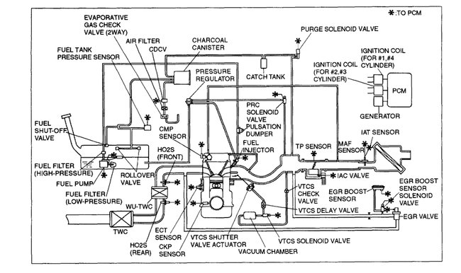

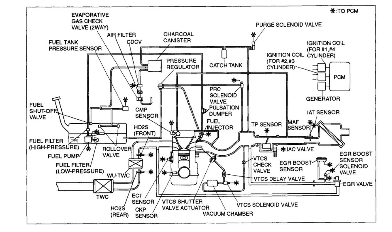

Hello, I was wondering anyone has a a vacuum diagram.
Jun 24, 2021 at 1:09 PM
DANNY L
  • 5,648 POSTS
Hello, I'm Danny.
Here is the information you requested. I've found 6 vacuum diagrams for your Mazda and attached them below. Sorry about the earlier spam response. Hope this helps and thanks for using 2CarPros.

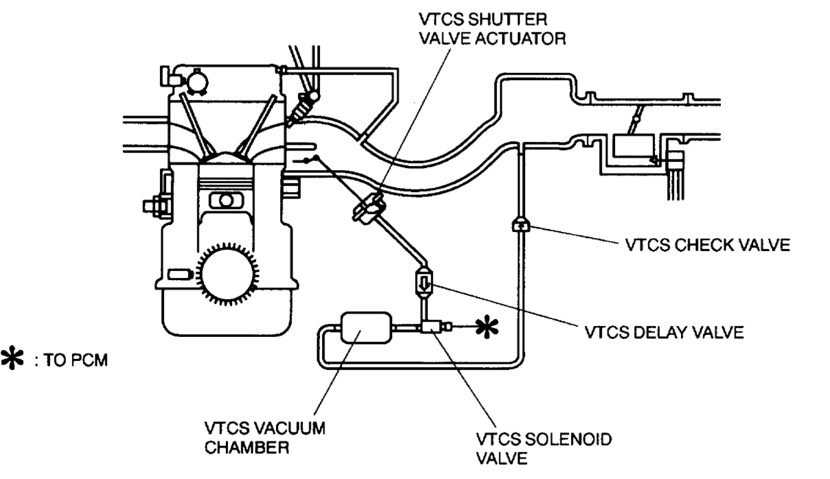

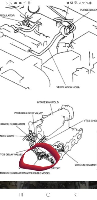

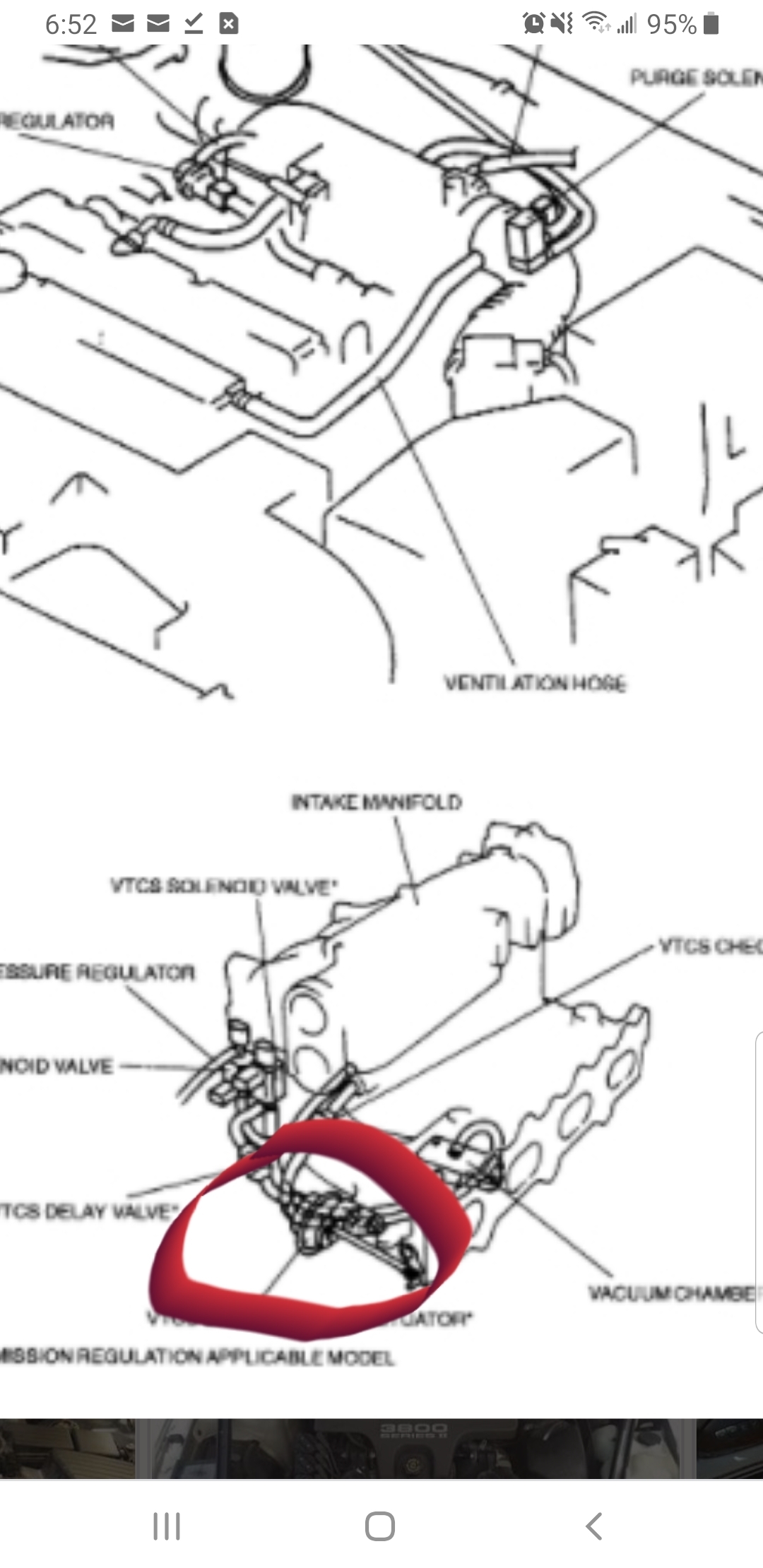

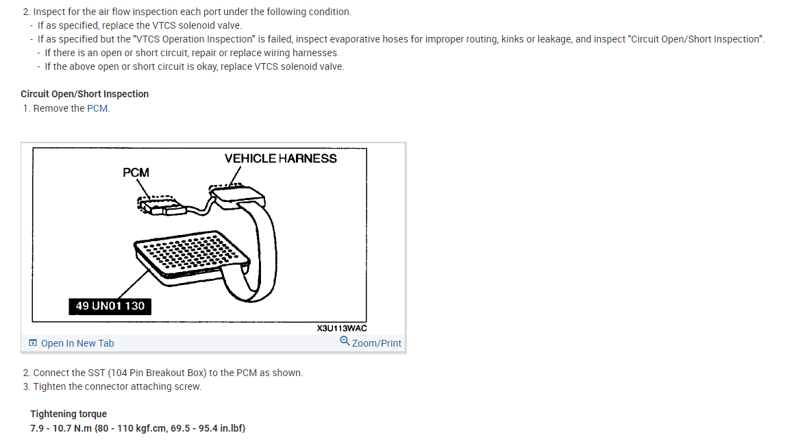

I am having ggv a problem trying to see which comes and goes through the vacuum chamber as well as the vtcs actuator.
Aug 12, 2021 at 8:54 AM
Can you give us the vehicle information so we can help you?
Aug 14, 2021 at 8:57 AM
DANNY L
  • 5,648 POSTS
Hello again.
For the proper engine vacuum line diagram we will need to know if your vehicle is equipped with the 1.6 or 1.8 liter engine. Let us know and we'll go from there. Hope this helps and thanks again for using 2CarPros.

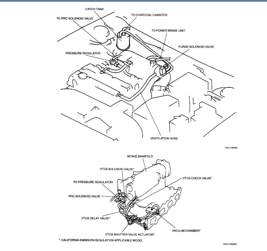

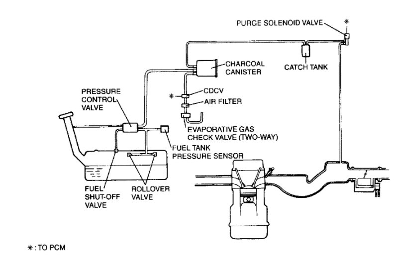

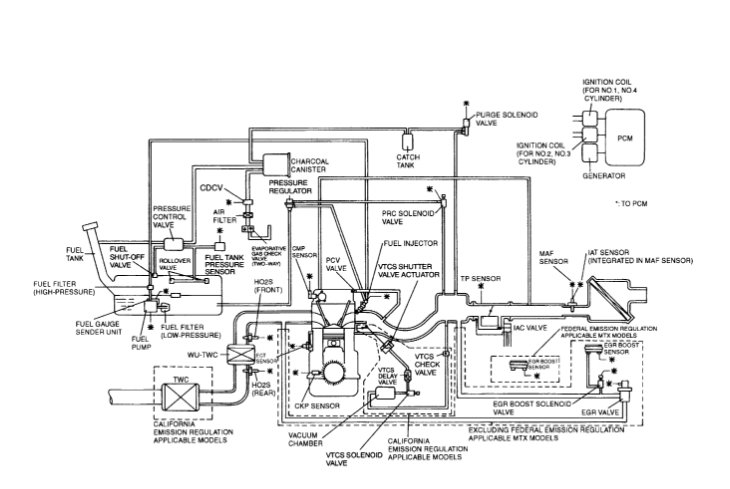

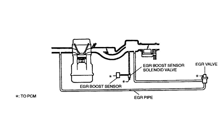

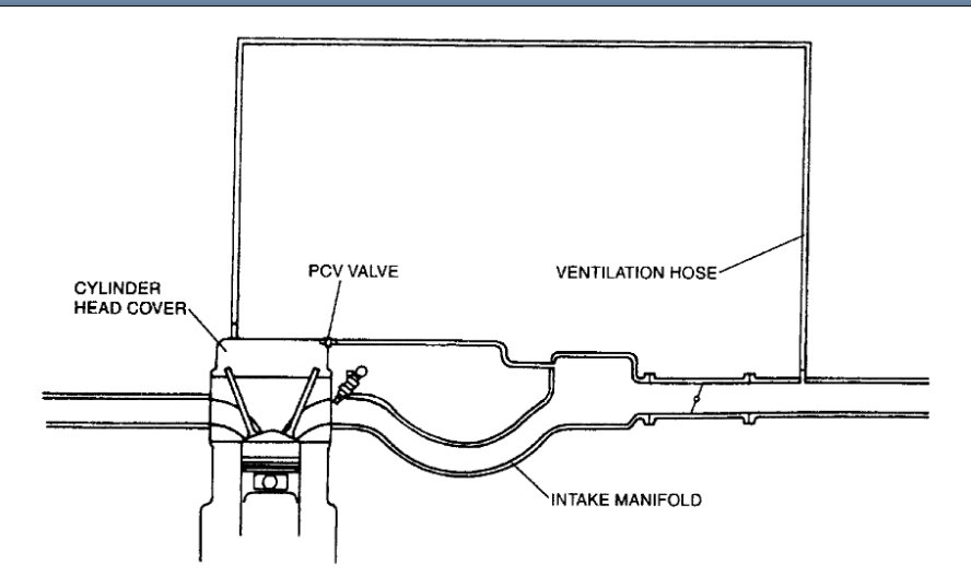

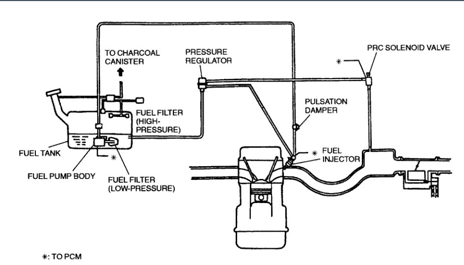

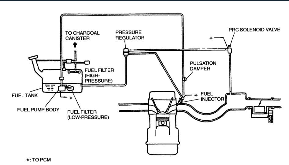

Mazda Protégé 2000 1.6.
Aug 17, 2021 at 6:15 PM

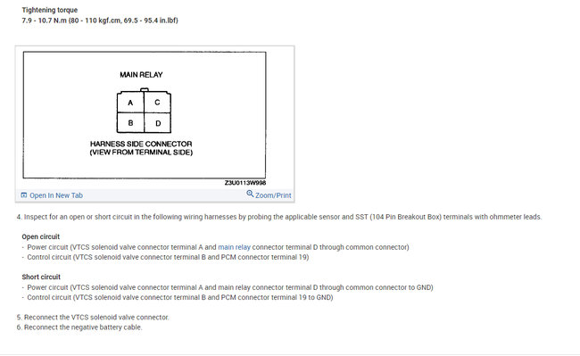

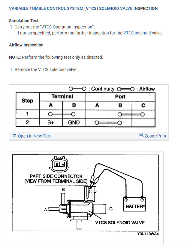

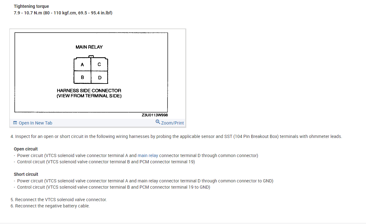

I attached the diagrams for you to view. Are these the correct diagrams for your car?
I also added the testing for the valve for you.
Aug 17, 2021 at 6:58 PM

Yes, I'm trying. I just put the head gasket in the car and put everything back and it's still s crank no start. So I'm trying to find how many ohms are in the MAP sensor, prc solenoid, VTCS solenoid, throttle position sensor, EGR valve. And the check valve I think I had the brown and green colored solenoid mix up.
Aug 26, 2021 at 9:09 AM
Did you do a compression test to verify the valve timing to be sure the belt alignment is correct? You need 140-160 pounds in each cylinder.
I would start there.
Aug 26, 2021 at 9:14 AM

After replacing the head gasket have you verified after the repair if you are getting proper fuel pressure and spark again since having a no start condition? Here is a tutorial showing how to test fuel pressure:
The fuel pressure specification for your car is 22 psi. Let us know and we'll go from there. Hope this helps and thanks again for using 2CarPros.
