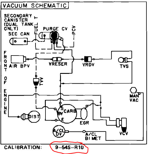

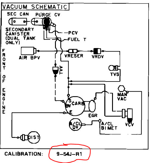

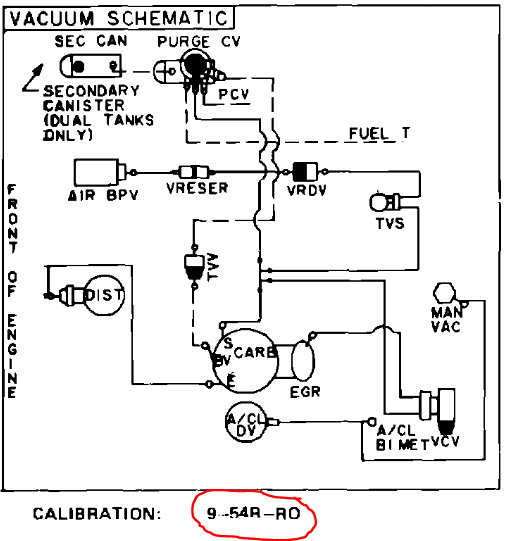

DANNY L
  • 5,648 POSTS

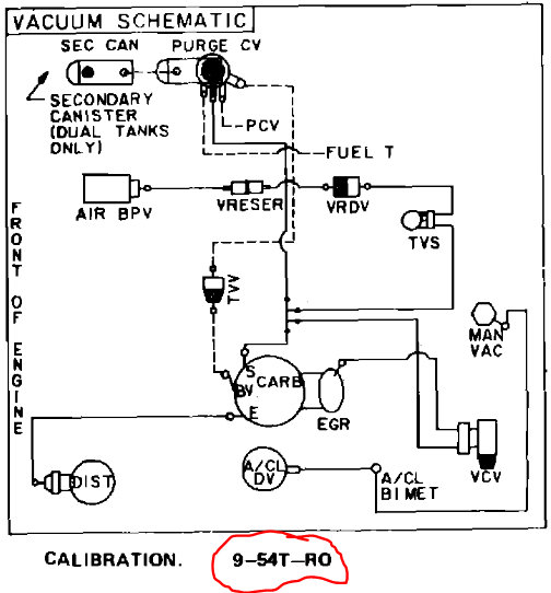

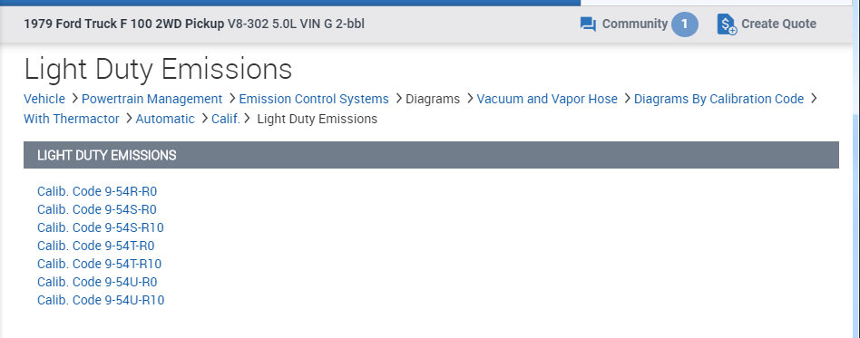

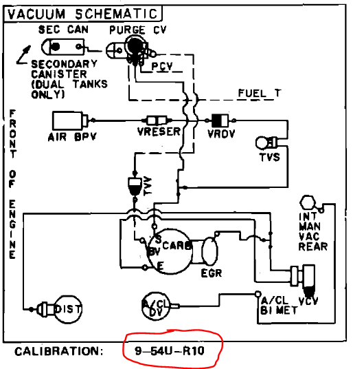

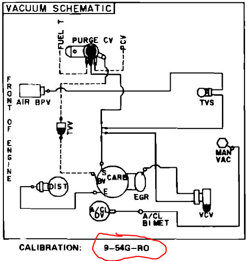

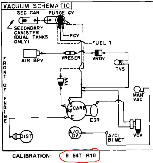

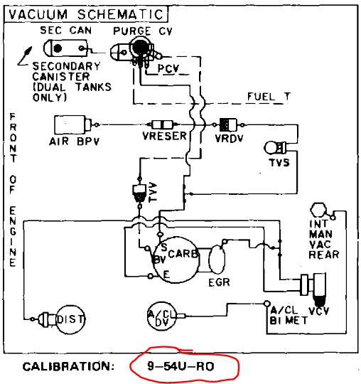

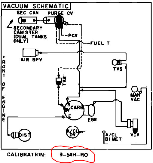

Hello again.

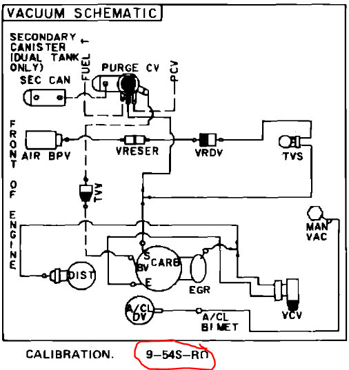

Here are the 7 California vacuum diagrams. They go by the calibration numbers which I've circled in red at the bottom. I've attached the pictures below.
Danny-
May 10, 2020 at 12:21 PM

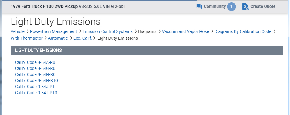

Hello again.

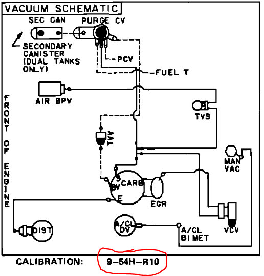

Here are the 6 Federal vacuum hose diagrams. As before they go by the calibration number circled in red at the bottom and I've attached them below.Just something to give you to start with.I'll get back with you tomorrow after getting more info from your VIN number.Hope this helps and thanks again for using 2CarPros.

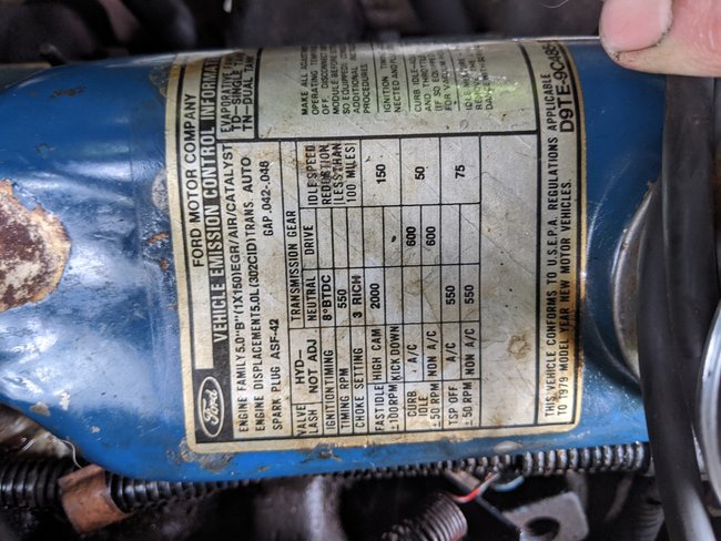

Were you able to decipher any numbers off of the blue emissions decal on the valve cover ? Hopefully it will have the calibration number.If not I will run your VIN number in the morning.Hope this helps and thanks again for using 2CarPros.

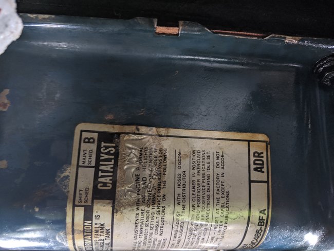

MANUEL MILLER
  • 21 POSTS

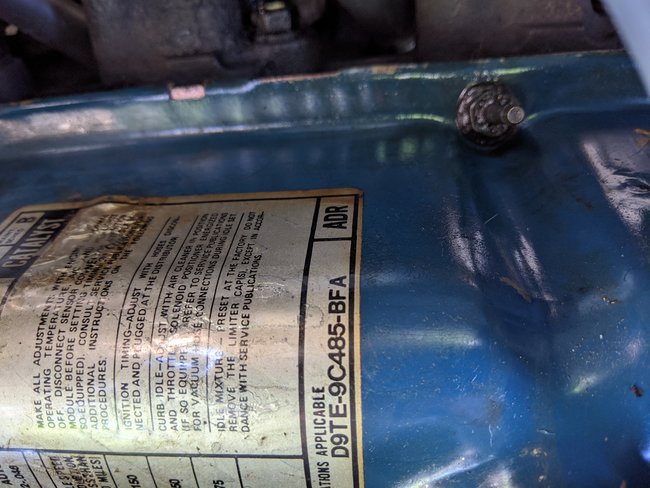

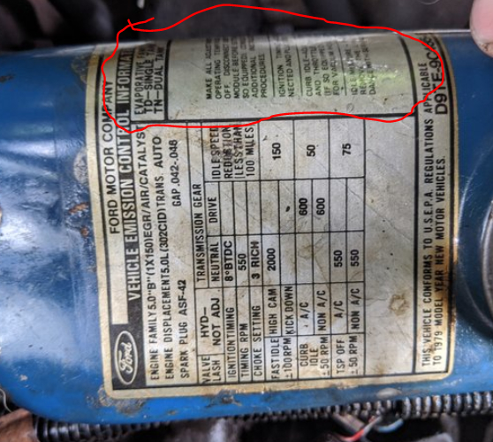

Here's the pictures of the emissions tag on valve cover.
May 12, 2020 at 2:05 AM
MANUEL MILLER
  • 21 POSTS
What exactly am I looking for?

DANNY L
  • 5,648 POSTS
Hello again.

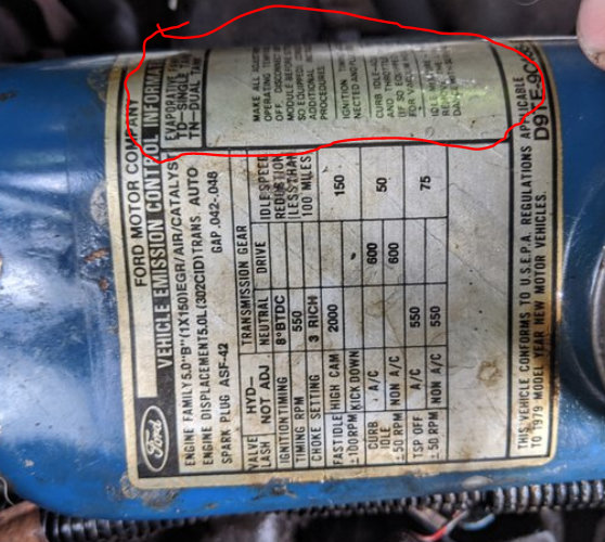

I tried getting the Ford dealer to look up info but they can't go back that far. I've attached your picture and circled the area in red.Can you use your phone to get a better picture of the area on the curve? Hope this helps and thanks again for using 2CarPros.
Danny-

Sure thing I'll get the picture first thing when the sun comes up tomorrow.

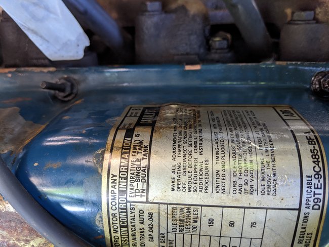

MANUEL MILLER
  • 21 POSTS

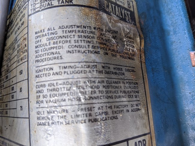

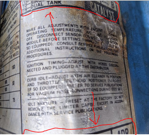

Here's the best I could get on the bend:
May 13, 2020 at 2:57 AM
DANNY L
  • 5,648 POSTS
Hello again.
The middle section came out well. I need the top and bottom to go by.We're getting there! I've attached the picture below and circled in red.Thanks again
Danny-

MANUEL MILLER
  • 21 POSTS
I hope this is correct.
May 14, 2020 at 1:47 AM
DANNY L
  • 5,648 POSTS
Hello again.
Yes, that's a great photo. One last question. Does your truck have a single gas tank or dual tanks?
Danny-

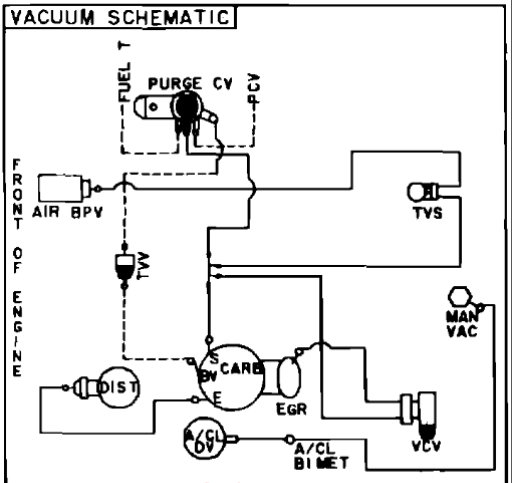

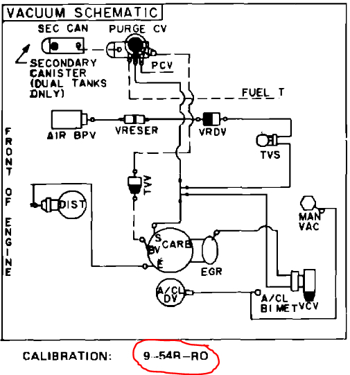

  • 5,648 POSTS

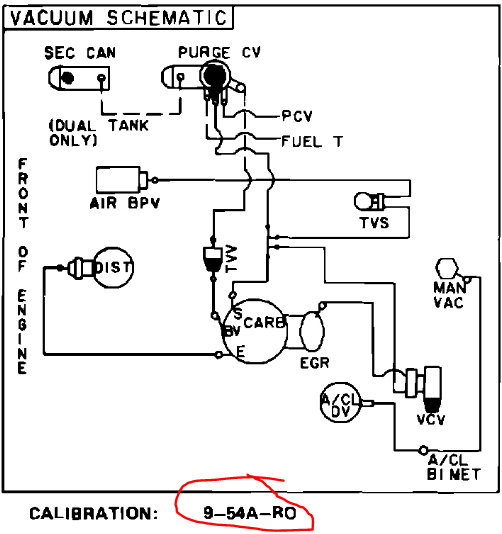

Hello again.

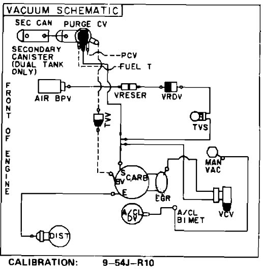

Okay, this will be your diagram for your single fuel tank- federal emissions truck. I've re attached a picture below.Hope this helps and thanks again for being patient and using 2CarPros.

MANUEL MILLER
  • 21 POSTS
I'm sorry but do you know what the abbreviations are? Like the TVS and the like. I haven't a clue only guesses.
May 14, 2020 at 2:16 PM
MANUEL MILLER
  • 21 POSTS
Or VCV.
MANUEL MILLER
  • 21 POSTS
TVV.
I did say this is my first automotive adventure. Always loved the old trucks just never had one to restore. Now I do.
May 14, 2020 at 2:18 PM

RENEE L
  • 1,260 POSTS
Hello, here are the definitions you were asking for the acronyms Danny posted:
VCV Vacuum control valve
TVV Thermal vacuum valve
TVS Thermal vacuum switch
If there are any others please do not hesitate to respond to this tread.
Thank you and a great rest of your day!

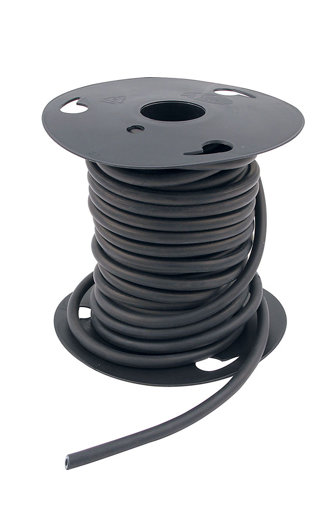

How do I know what size tubing to use?

The majority of the vacuum lines on your truck are 5/32 I.D. Hope this helps and thanks again for using 2CarPros. I've attached a picture below.Please feel free to use us again in the future for your automotive questions.
