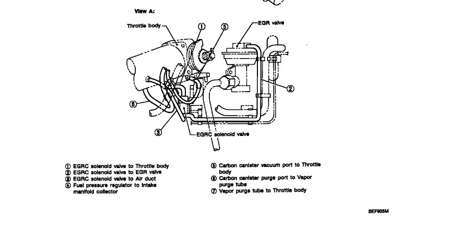

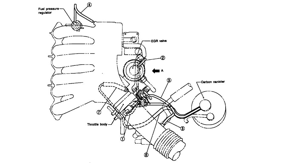

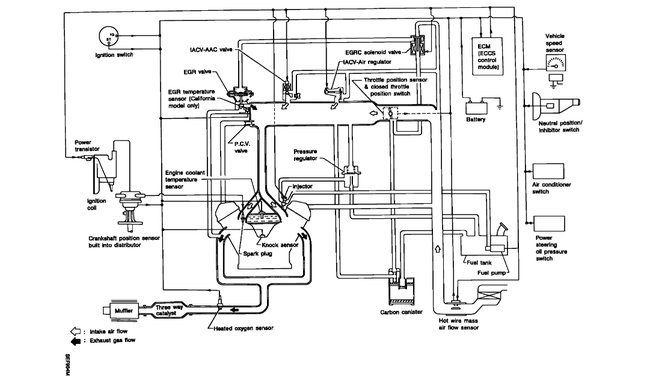

replaced the engine now can't find where the brake booster vacuum line connects.also please can you give me the vacuum diagram for the engine? so i can check them. thanks. Help

I have included the information that you requested in the diagrams down below. Please go through them and get back to us with what you are able to find out. I hope this helps.

i need the connection points for the brake power booster. thank you

Unfortunately there aren't any diagrams for your vehicle that show specifically where the brake boost vacuum hose attaches. In most cases though, that particular hose should connect directly to the intake manifold somewhere on the engine side of the throttle body. If you start the engine with that hose disconnected, you should be able to hear and locate a fairly significant vacuum leak.
