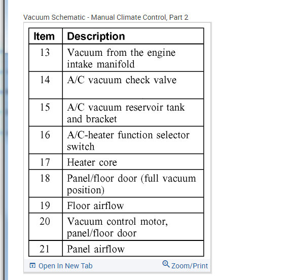

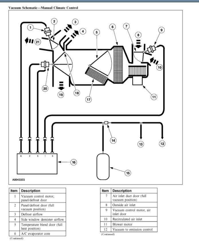

Below are the vacuum diagrams that they provide. Basically this is just for the HVAC so let us know what exactly you are looking for and I will see if I can find better diagrams. Is there an issue that you are seeing that you need the diagrams?

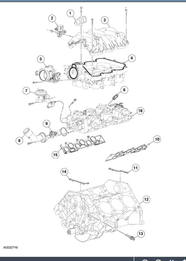

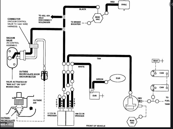

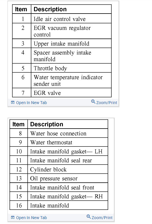

They are hard to find, both Alldata and Mitchell1 do not have them but I found this online let me know if it works. Check out the diagrams (below). Please let us know what happens.

I'm needing the diagram for the engine vacuum lines I have rough idling and stalling
