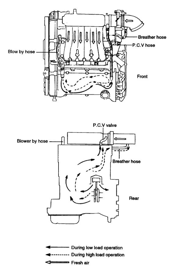

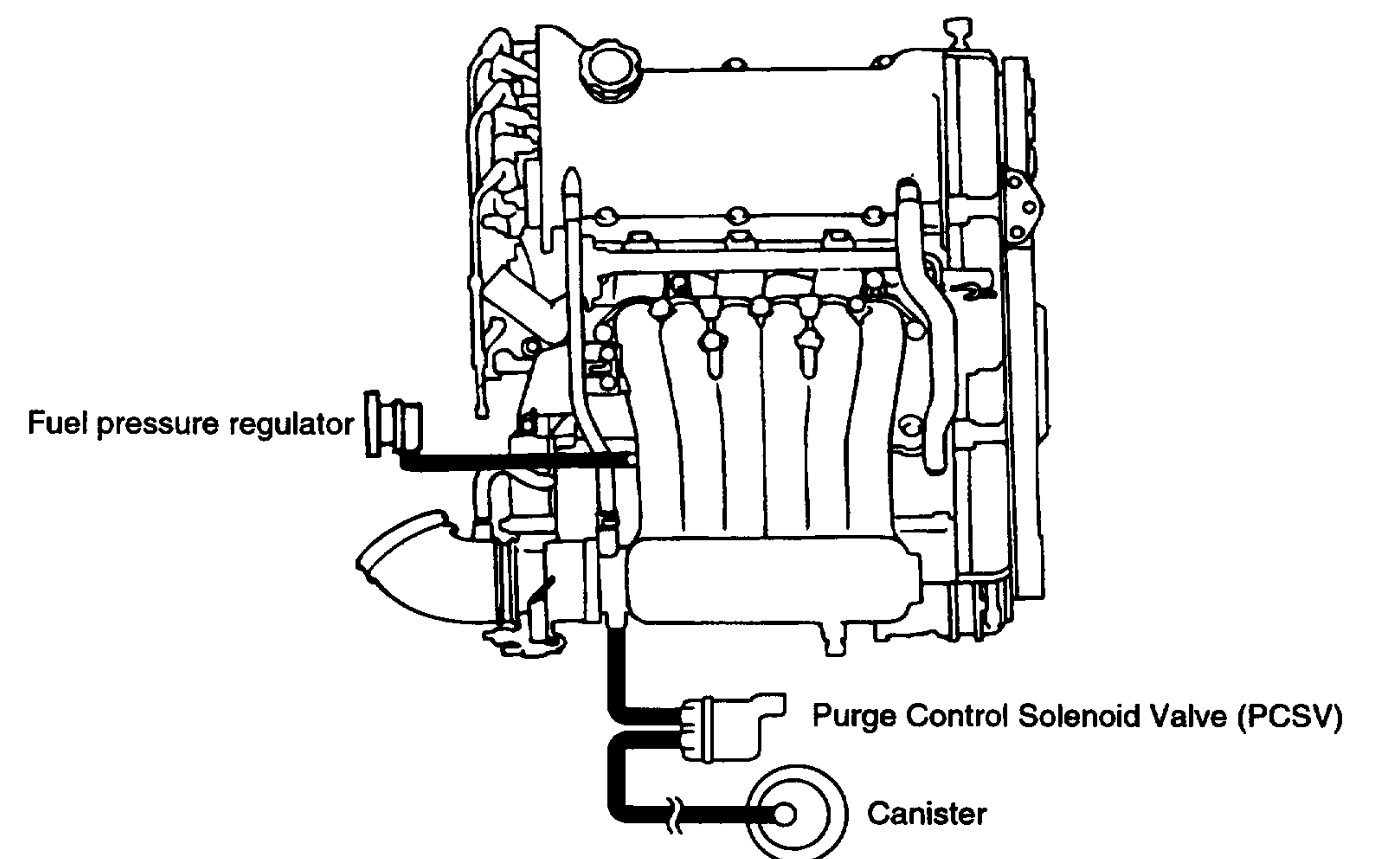

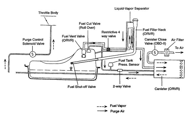

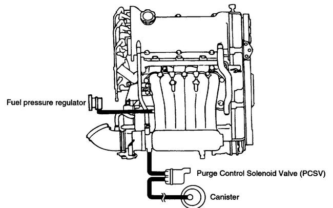

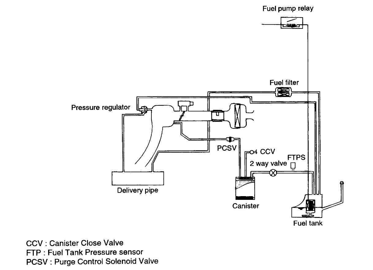

I need a vacuum line diagram for my car listed above. Thank you
Sep 13, 2023 at 3:38 PM
STEVE W.
  • 15,411 POSTS
These are the diagrams they show for that engine, however you should have a sticker with the routing information under the hood as well. The first one is the fuel and vapor lines as well as the EVAP lines under the vehicle. The second is the PCV system, third is for the fuel vapor recovery system and the last is the top vacuum lines. What issue are you having?
