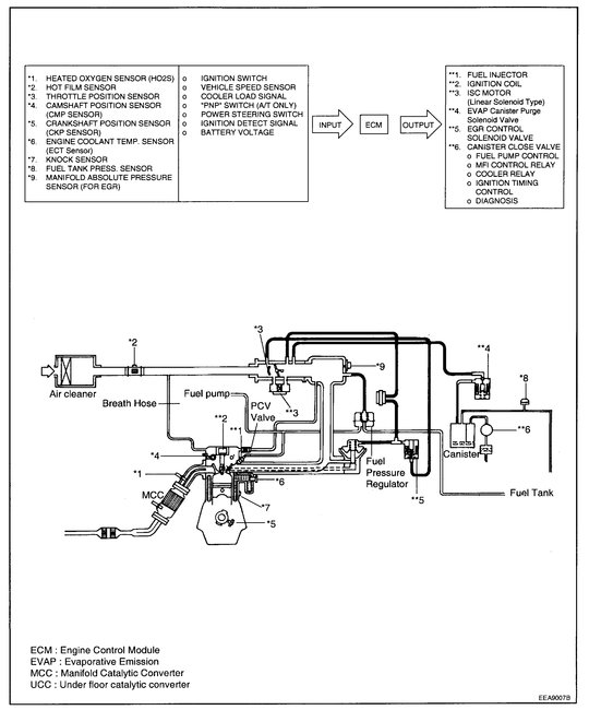

I have high idle replaced all the vacuum lines EGR valve and idle air control valve did not do electrical test or resistance for anything. I did clean the and take replace the 02 sensors up-and-down stream and the exhaust manifold gasket.
Oct 26, 2020 at 2:22 AM
  • 110,241 POSTS

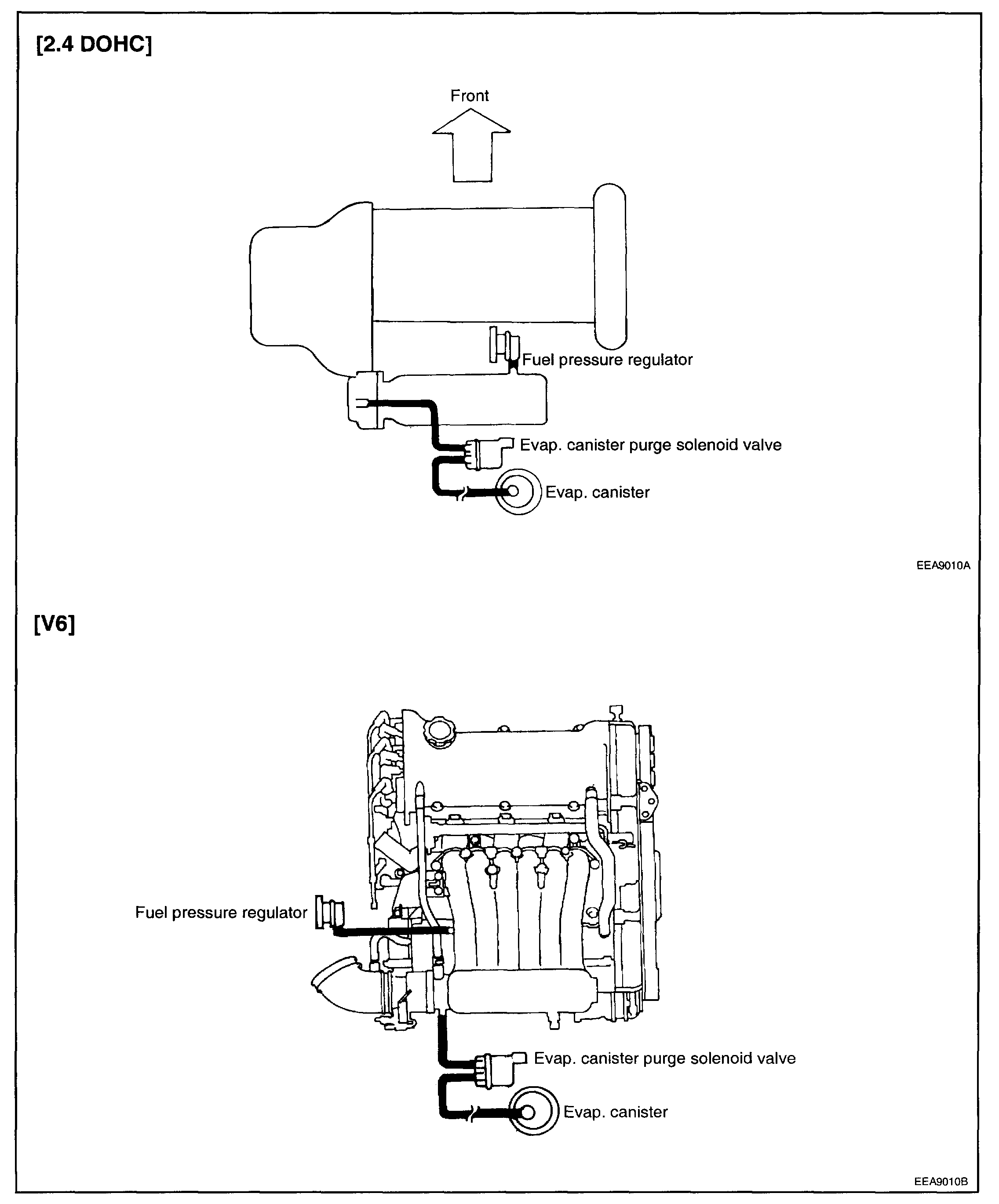

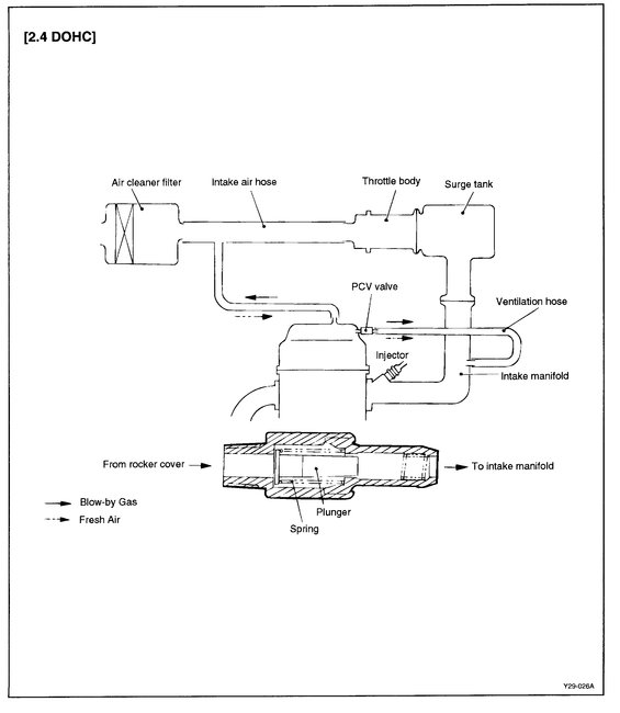

I have attached the vacuum schematics for the vehicle. Have you checked the PCV system? See pic 3 regarding the system. Also, here are two links. The first explains how to find a vacuum leak and the second helps with high idle issues.
https://www.2carpros.com/articles/engine-idles-too-high
