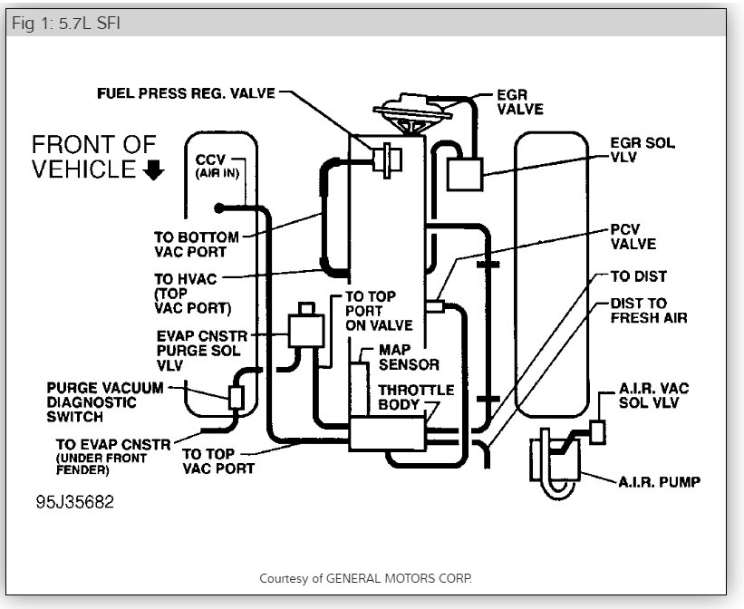

Looking for a vacuum diagram for 1997 Camaro SS 5.7 liter.

Sure, here are the engine vacuum line diagrams as you have requested. Check out the images (below). Let us know if you need anything else.
