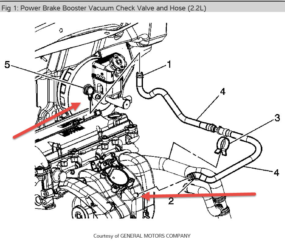

My car has a loose vacuum line that connects the brake booster to the intake manifold I believe. I cannot find where the vacuum line connects to the manifold. Please help!
Dec 30, 2016 at 2:07 AM
HMAC300
  • 48,601 POSTS
Here is the engine vacuum line diagrams for the power brake booster. Check out the diagrams (Below). Please let us know if you need anything else to get the problem fixed.

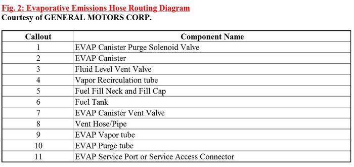

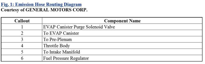

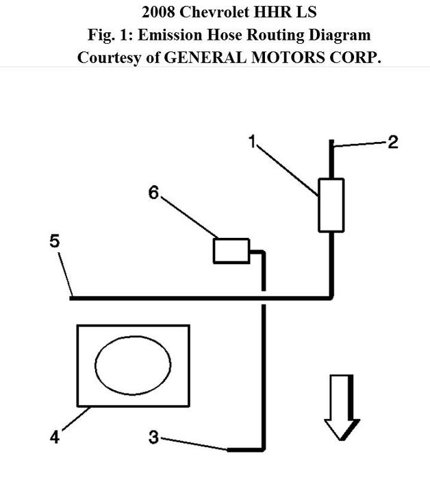

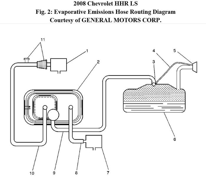

2008 Chevy HHR SS 2.0L Turbo. I need the engine vacuum diagram, there isnt one under the hood
Mar 1, 2019 at 11:00 AM (Merged)
KHLOW2008
  • 41,814 POSTS
These are all I have of the vacuum lines. Hope they are helpful.
