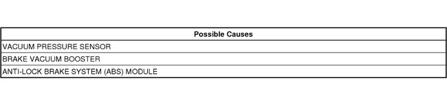

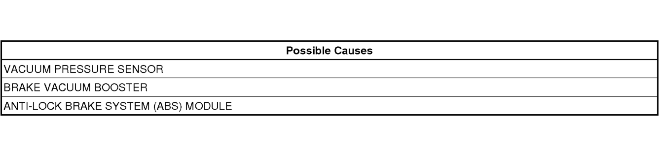

Dear,
The pedal brake becomes very hard if the engine isn't turned on for more than four days. Moreover the stability light turns on at a long descent. Once the car is turned off and turned on, the stability light is off.
The scanner gave the code C1082-02. The technician told we have to change the booster. But even with the new booster the problem repeated. If the problem of the stability light repeats several times the car does misfire.
Best regards.
Dec 27, 2018 at 8:08 PM
Good morning,
Is the brake pedal still hard as well? did the new booster resolve that issue?
below is a description of the code and possible failures.
Has anyone checked this out and given you suggestion? I looks like a vacuum issue. are there any broken or missing hoses from the engine?
C1082-02-VACUUM PRESSURE SENSOR - GENERAL SIGNAL FAILURE
