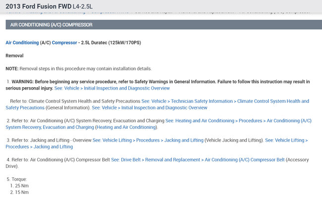

Cooling fan comes on and off. While getting my oil changed at local Ford the tech showed me that my vacuum pump was leaking oil. Brakes are good A/C not. Should I just go and replace the pump or just the seals? The A/C is holding refrigerant. Can the vacuum pump cause A/C to blow warm.

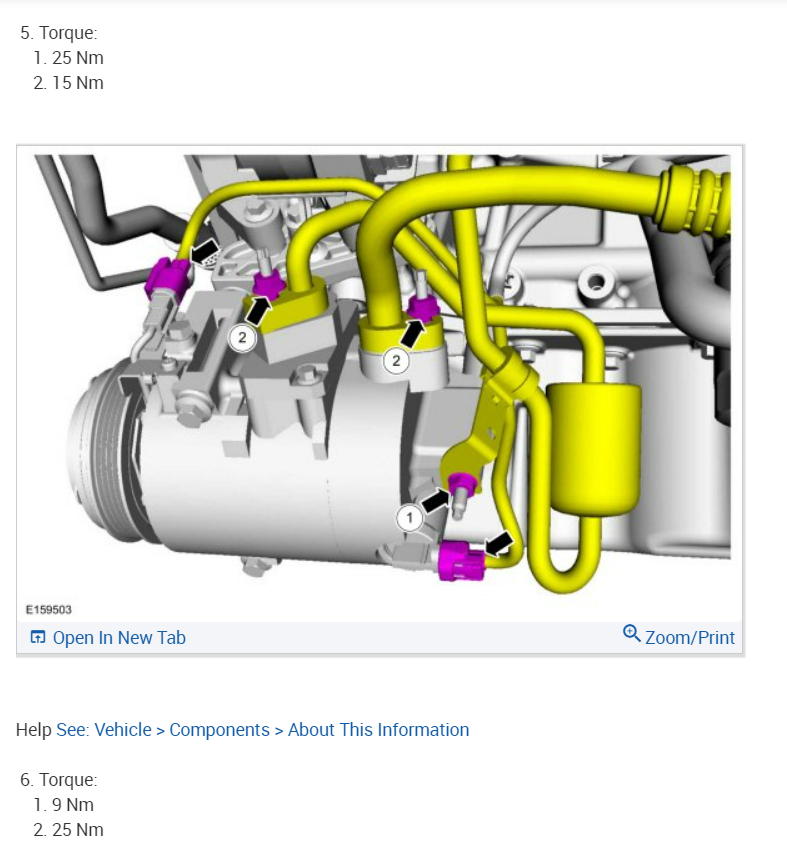

vacuum pump? Do you mean the compressor? We should get a set of pressure gauges on the system to see if the seals are bad inside the compressor. Please go over this video and guide:
https://youtu.be/4EqdrBVb0sY?si=mJxyc2pJM_acueHn
and
If the pressure is about the same form high to low side the compressor is bad. Here is a generic guide to help you step by step with instructions in the diagrams below to show you how on your car:
https://www.2carpros.com/articles/replace-air-conditioner-compressor
