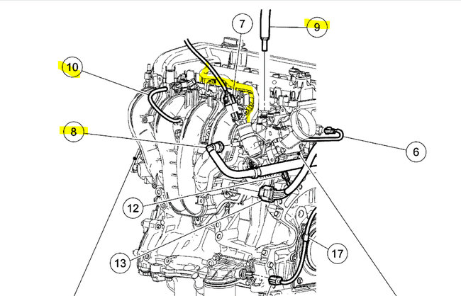

We put a new intake my son didn't label the vacuum connections. when i plug everything in where i think they go it starts fine but idles at about 3,500 RPMs, can't get it to go lower. any ideas?
Oct 18, 2021 at 9:10 AM
  • 110,248 POSTS

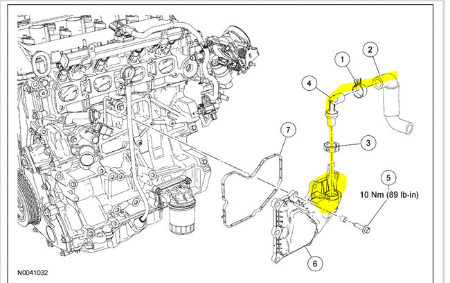

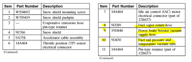

I attached a few pics below. I highlighted four things in the pic related to vacuum and the intake. My one concern is the PCV was left disconnected, or the hose was damaged. I believe on this engine; the intake needs to be removed to access it. See pic 3.
If you find everything is good, here is a link you may find helpful. It explains how to locate and repair an engine vacuum leak.
