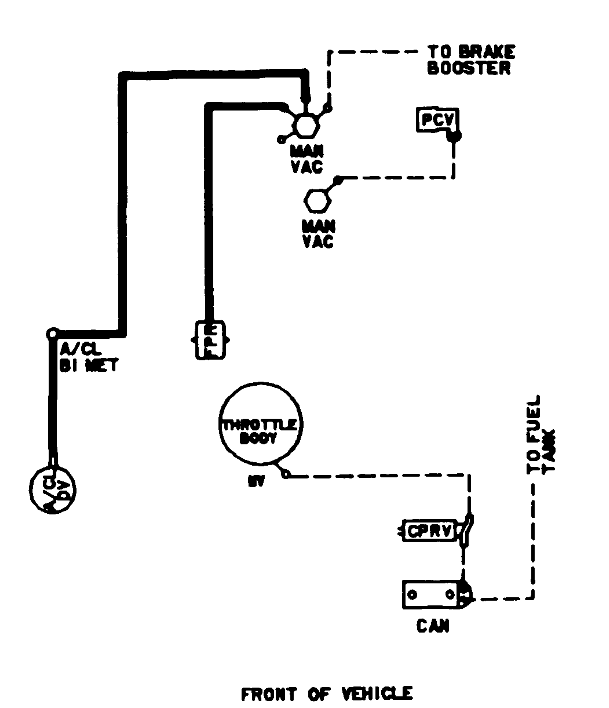

hey folks, i just rebuilt the motor and need a diagram for the vacuum and plug ins just to make sure i have them right.thanks for your help
Dec 9, 2020 at 5:59 AM (Merged)
BMRFIXIT
  • 19,053 POSTS
Here is the engine vacuum lines in the diagrams below.

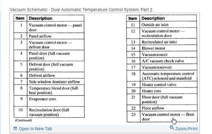

TFRANK386
My vehicle blows hot air continually even with the thermostat indicator on the cool setting. I am sure one of or more of the hoses are crossed up. Can I get the correct hose diagram for this?
Good evening.
I attached a couple of vacuum diagrams for you to view. Check out the diagrams (Below). Please let us know if you need anything else to get the problem fixed.

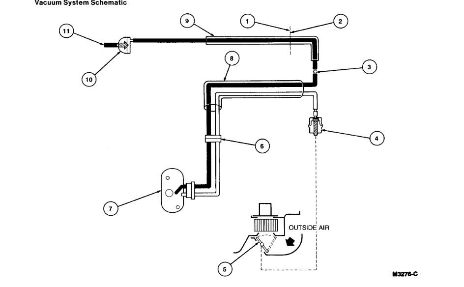

MALONG23236
One of the six lines on my upper intake manifold vacuum tree is broken/open/exposed. I cannot find the end that it connects to. I looked in the Haynes Repair Manual but could not find the scheme that diagram the connection. I also when to the Ford website. Is there another source?
Dec 9, 2020 at 6:00 AM (Merged)
DAVE H
  • 13,384 POSTS
https://images.2carpros.com/forum/automotive_pictures/266999_vac_3.jpg

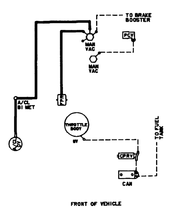

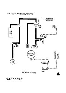

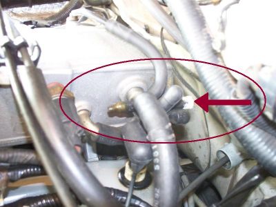

BARRELRACER400HP
I have a 1993 Ford explorer xlt 4x4 with a 4.0 liter that has 64,000 miles. I picked this vehicle up a month ago and it was loping at accellerationb so I checked vaccum lines. I found a vaccume line was missing, with a stub and a screw in the end to replace it. The vacuum line chart only shows a few vacuum lines and I cant find the end of the line, is there any complete chart?
https://images.2carpros.com/forum/automotive_pictures/104840_red_arrow_2.jpg
Also, It makes a single clunk when turning the wheels either way. I just replaced the front shocks, lubricated every nook and cranny available to stop some annoying squeeking, hoping the noise was friction, but its still doing it. I just had the hubs serviced and learned one of fords dumber ideas is that you can't lubricate the ball joints. My mechanic explained that when they get dry you just have to replace them.... Do you thing this could be the noise? It doesnt sound like a serious problem but I have noticed speeds over 55, there is a light shudder comming from the front end... It could also be the age and everything has seen better days, but if you could just ease my mind, Thanks!

MERLIN2021
  • 17,250 POSTS
To get the propper diagram for your truck I need the ca;ibration code! It should be on the drivers door jamb, and on one ot the valve covers...To test the ball jpoints, jack the truck with a floor jack, under the ball joit as close to the tire as you can, then try to shake the whell by placing your hands at 1200 oclock and 6 oclock. then at 3 and 9, any play? Play means something is worn...could be tie rod ends or ball joints...clunk can be ball joint or control arm bushings...It looks like all 4.0 goes from the throttle body to the cannister purge...

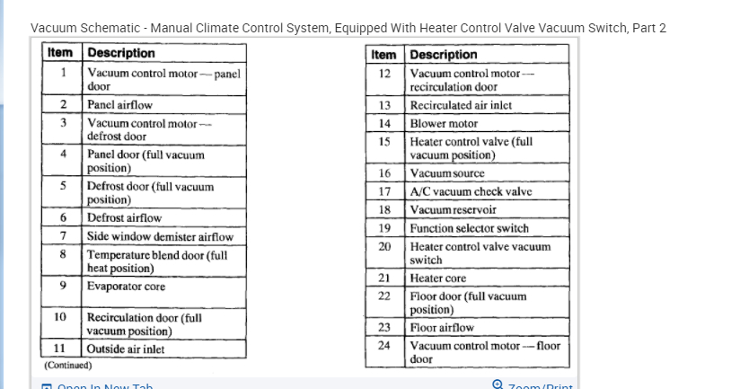

BIGDADDY999
  • 5 POSTS
i have 1 small vacuum line that is broken,coming from drivers side to passenger side
the 2nd one is by the air conditioner one end goes into a circle cap and comes out of it , but it looks like the bottom is broken
where do they come from and where do they go

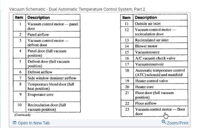

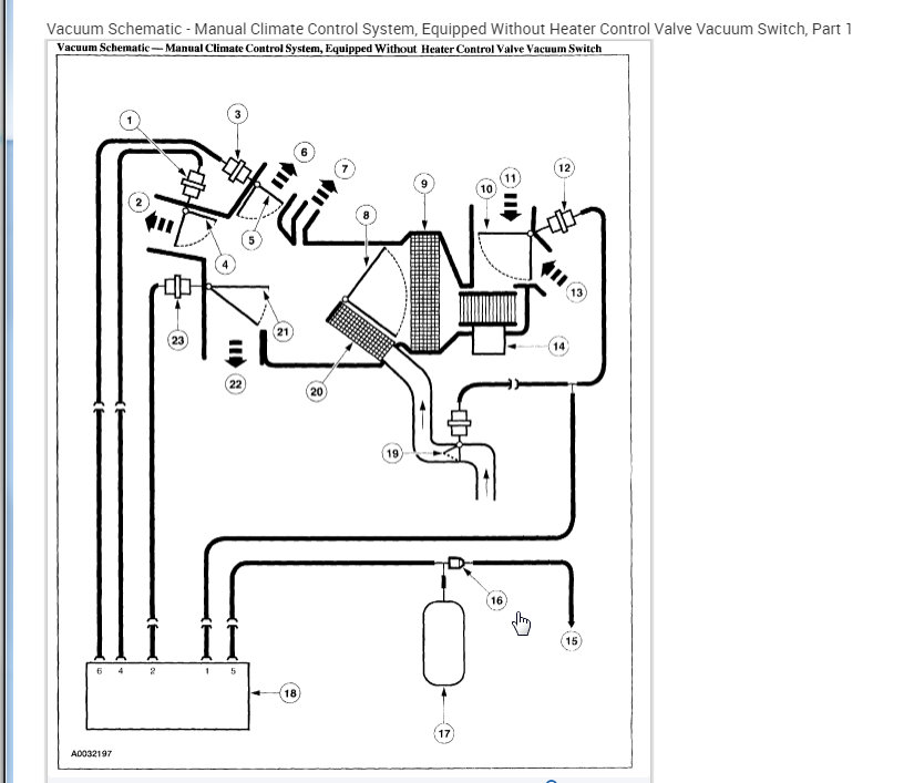

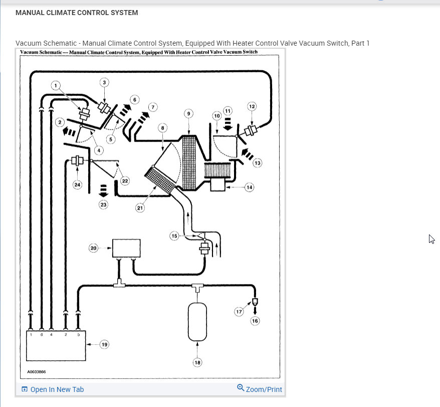

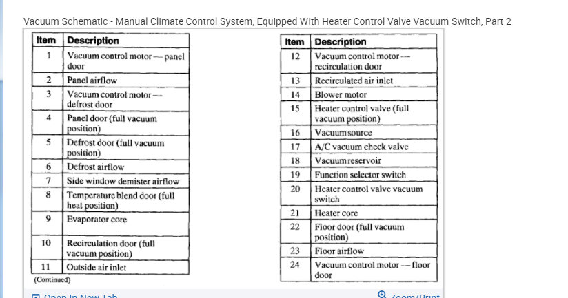

HMAC300
  • 48,601 POSTS
heres a diagram you can look and see where you are talking about.

BIGDADDY999
  • 5 POSTS
what do the abreviations mean in your diagram, please tell me what they are thank you
