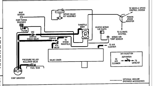

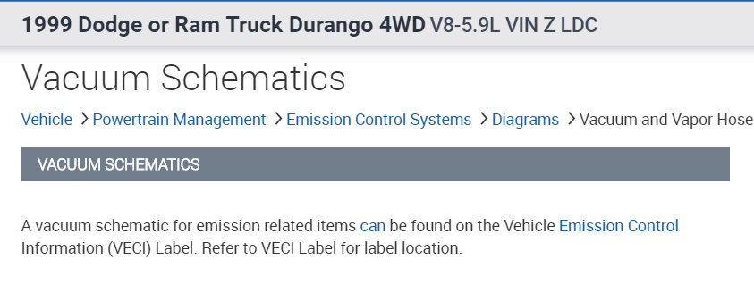

Trying to find out where a vacum hose leads to, need diagram
May 22, 2019 at 10:47 AM
SCGRANTURISMO
  • 4,897 POSTS
Your vehicle's vacuum hose diagram is locates on the hood of your vehicle on the Vehicle Emission Control Information Label (VECI) sticker. I have included more information about your vehicle's vacuum hose routing diagram in the diagrams down below. Please go through the information and get back to us with how everything turns out.
