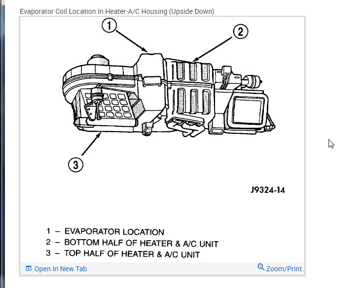

my A/C quit cooling. I recharged with dye. no leaks shown. A/C cooled well for a day. next day compressor fried. today I installed new compressor and dryer. put a vacuum on it for an hour, shut pump off and in three minutes the vacuum was gone. how do I find this slow leak that's not so slow?

If you have searched the components in the engine bay, just make sure you check the lines and the evaporator in the HVAC housing. Clearly this is not going to be readily accessible but I would pull the blower motor out and use a borescope if needed to view in there. However, if this is the case you should find all sorts of dye and oil in there where it is leaking out.

I had already read through all those other means of seeking the leak, but those needed the system charged. Mine has been vacuumed. But I will look in the evaporator area with a black light. How long would the dye be active?

Sounds good. It shows up until it is cleaned off so if it’s there you will see it. Let us know. Thanks.
