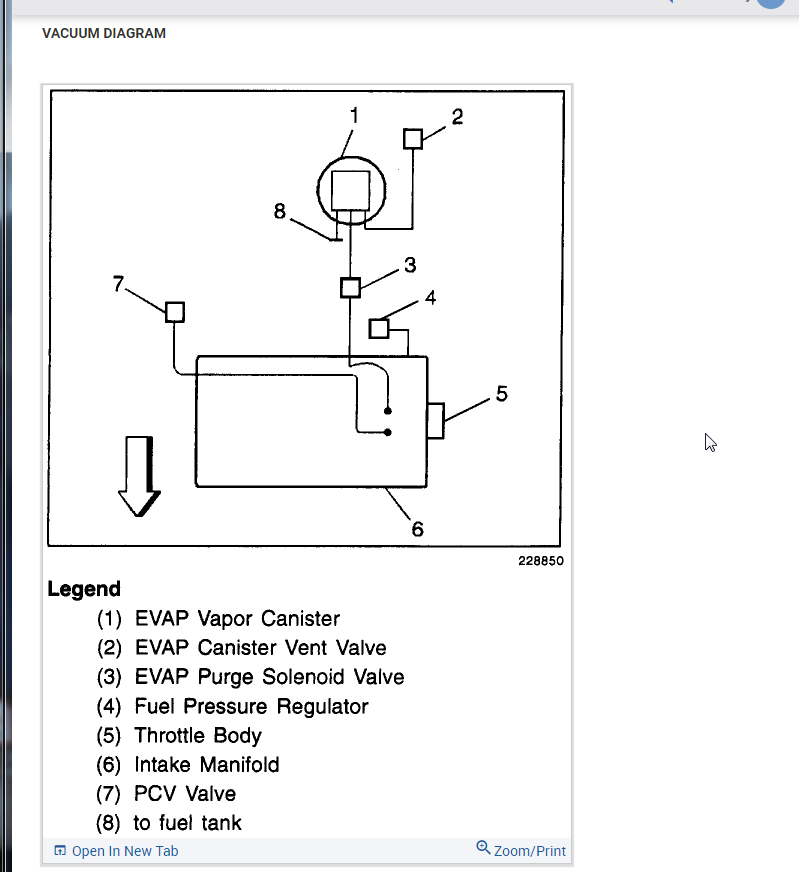

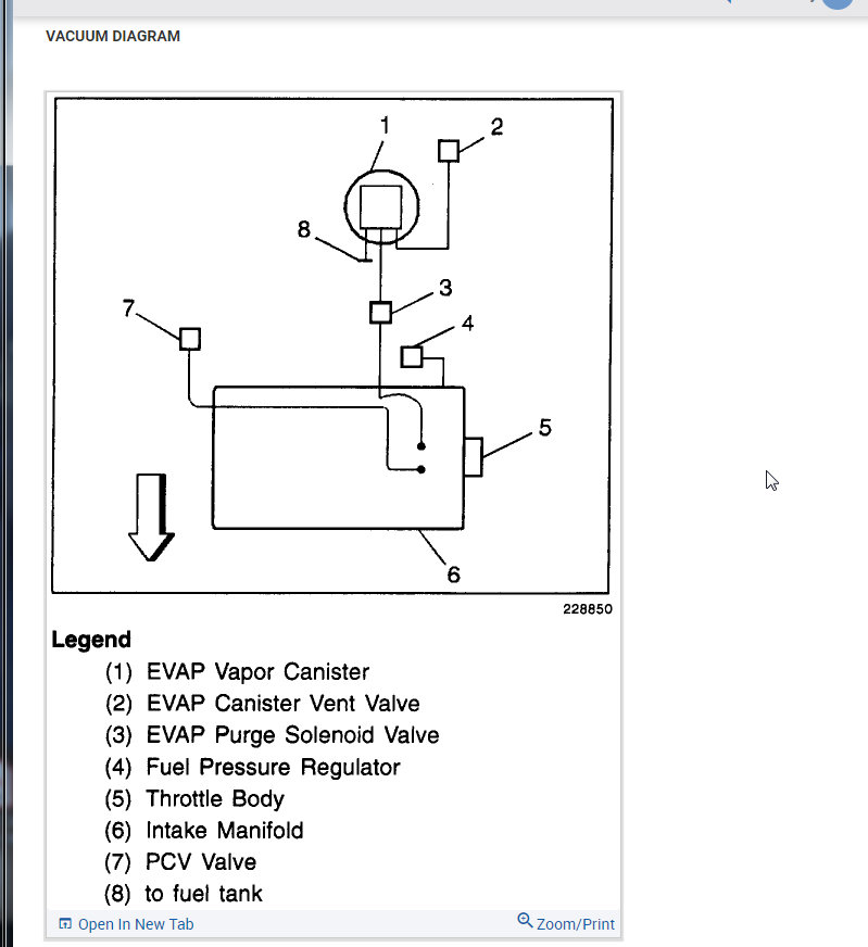

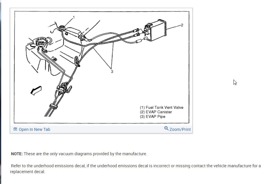

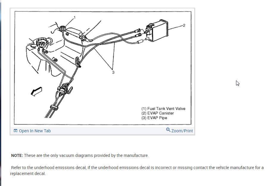

Vacuum lines have been disconnected not by me. do you have a picture of the routing the vacuum lines.

I am attaching the diagrams from the manual. Let us know if you need more info and we can dig deeper if needed. Check out the diagrams (Below). Please let us know if you need anything else to get the problem fixed. Thanks
