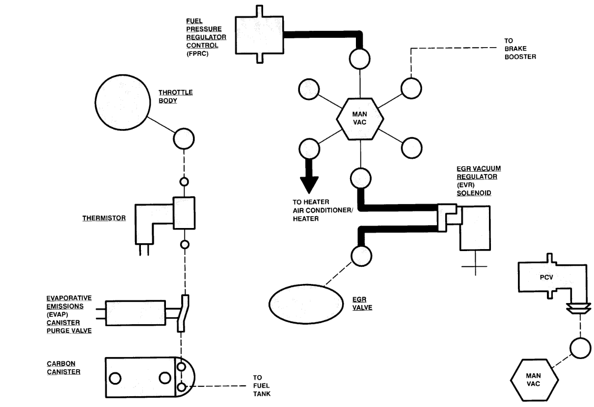

Hello, i need the diagram to the engine vacuum diagram for the truck listed above.
Thank you

They just give us this, sorry I was not more help. Check out the images (below). Let us know if you need anything else.
Image (Click to enlarge)
