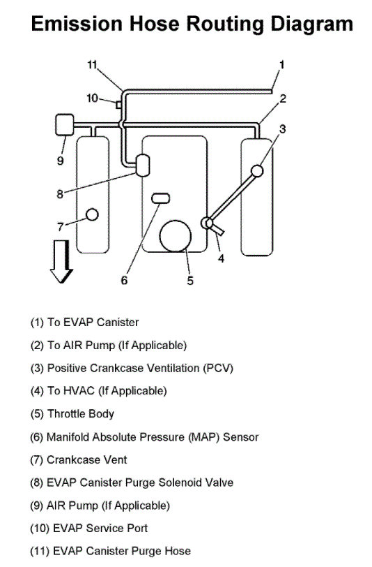

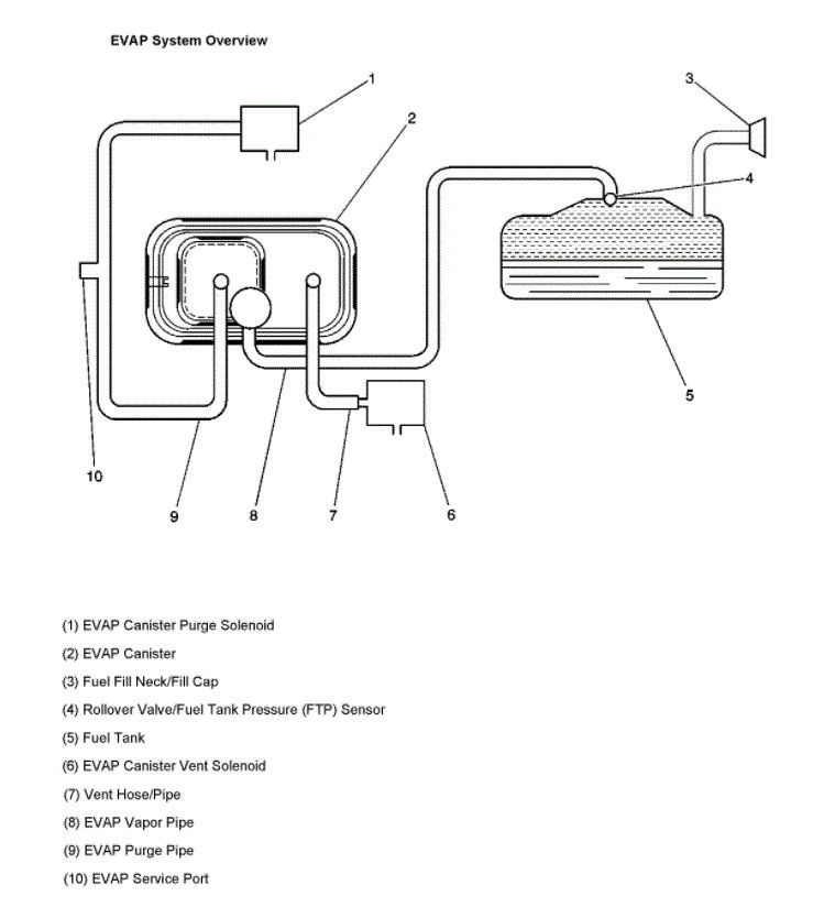

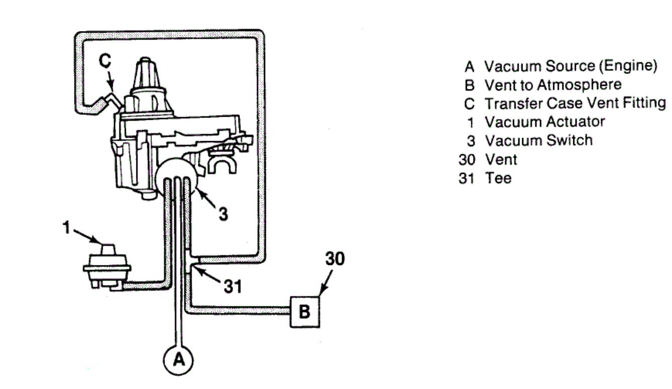

Diagram for 4-wheel drive under hood to the transfer case vacuum switch needed
2003 CHEVROLET BLAZER
175,000 MILES • 4.3L • 6 CYL • 4WD • AUTOMATIC
BRYNJA ULLRICH
All vacuum lines were missing when I bought the car.
Nov 28, 2021 at 1:20 PM
  • 110,194 POSTS
Are there no vacuum hoses whatsoever? I'm surprised it was running. LOL Regardless, I attached vacuum schematics for the EVAP system and the 4wd system. For some reason, the 4wd schematic is somewhat vague.
Take a look through them and let me know if you have questions. I'll try my best to help from here.
I hope this helps.
