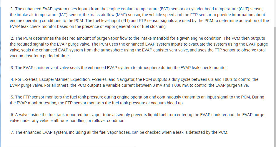

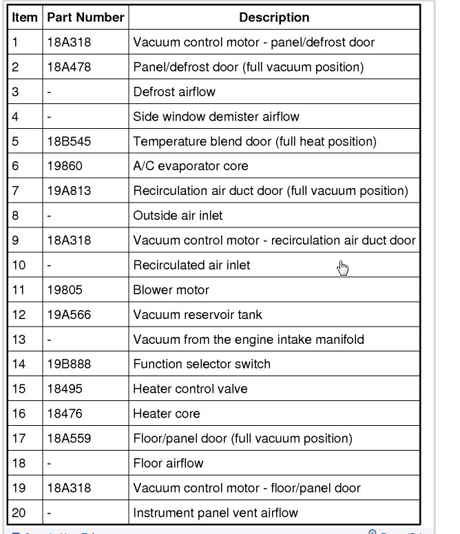

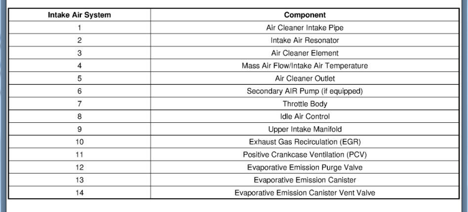

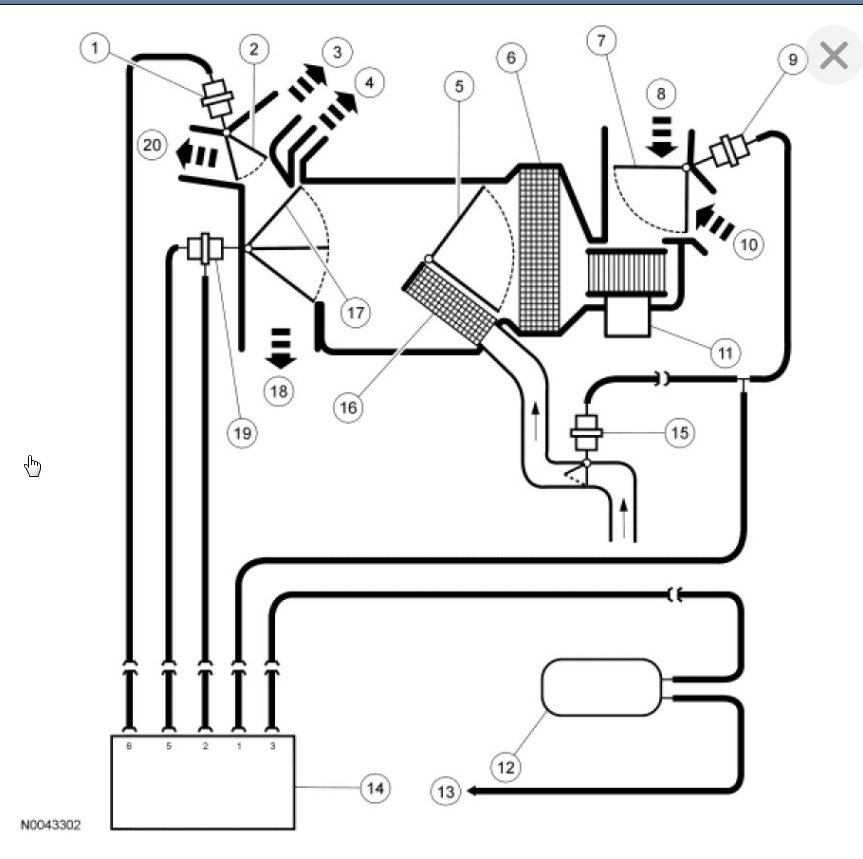

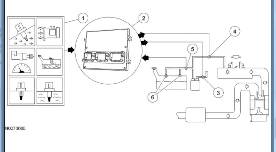

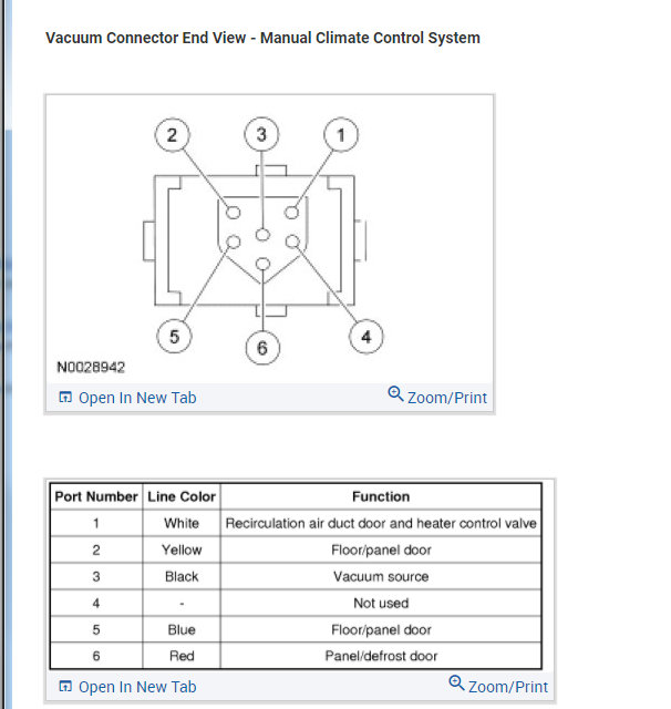

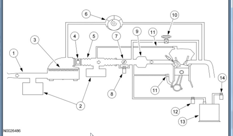

So i blew original motor some, so called friend said they could replace motor. well, they cut hoses and i'm putting new/used motor in and am not sure on how lines hook-up.. Any help is greatly appreciated. I've gotten everything else set in place except these hoses..
Mar 28, 2021 at 5:38 PM
Unfortunately there is not one diagram for the vacuum lines but I attached the info from the manual on all the different vacuum operated systems. It shows what systems are attached to each other but again it is going to have to be worked through.
Please run through this material and let us know what questions you have. If you still have issues get some pictures of the hoses and their location so that we can try and figure out what they are. Thanks
