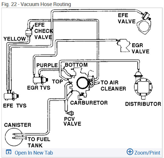

I need diagrams for all the vacuum and hose routings in the engine bay

Yep, those can be difficult to come by, let me see what I can find. Okay, here you go. Check out the images (below). Let us know if you need anything else.
