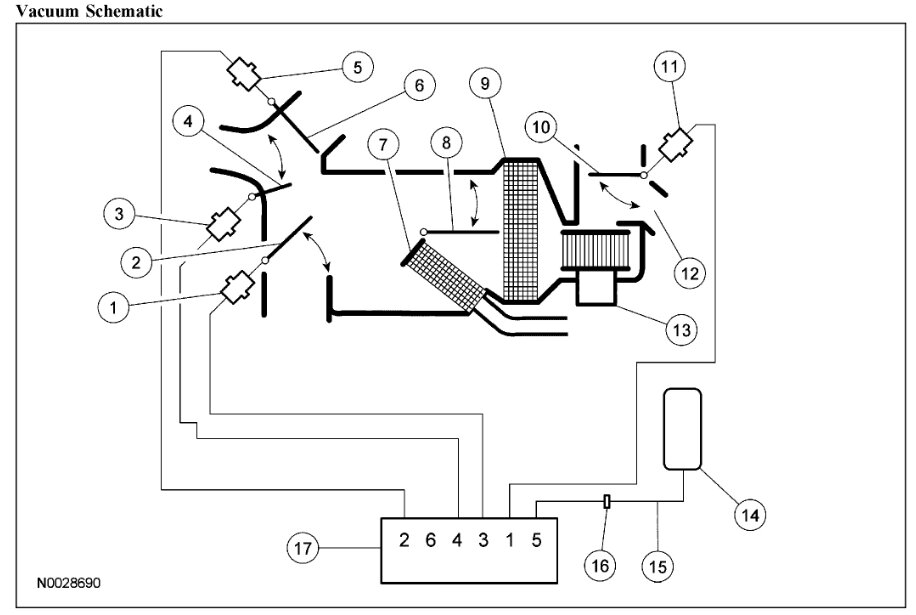

Can I get a vacuum hose diagram?
2006 MERCURY MARINER
15,000 MILES • 3.0L • 6 CYL • 2WD • AUTOMATIC
EARL91
  • 88 POSTS
All hoses have rotted away. I also need help with the camshaft positioning sensor. What are the ohms of resistance supposed to be for a good sensor?

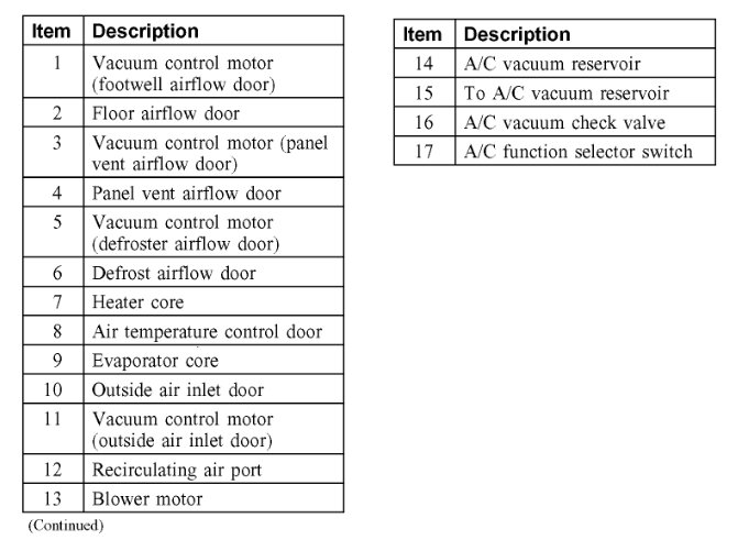

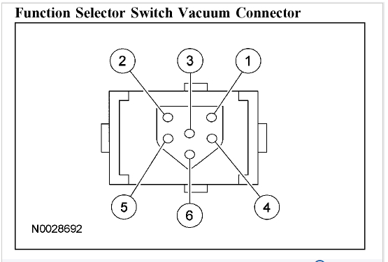

I've gone through two manuals and the only schematic they offer for this vehicle is for the HVAC system. I attached it below but doubt that is what you need.
If you can let me know a specific component that you need vacuum hose info on, I may be able to find it that way, so let me know.
