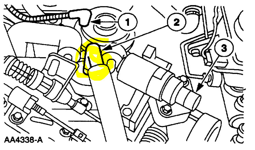

Where does the PCV line go from the PCV?

Does it run to the bottom of the intake manifold?

The PCV hose runs from the valve to the intake manifold. If you look at pic 1, I highlighted it for you. It will be near the EGR and throttle body.
Let me know if this helps.
See pic below.

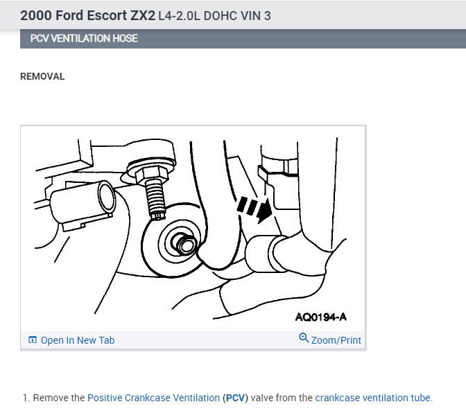

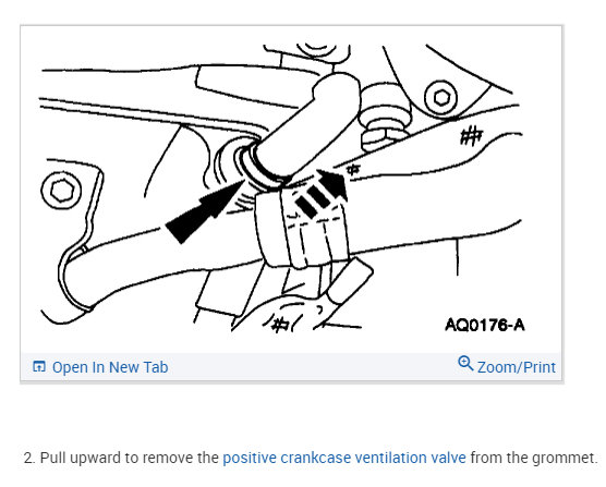

Wrong on zx2.

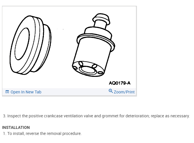

I attached everything I had for the ZX2. Take a look through it and let me know if it helps.
