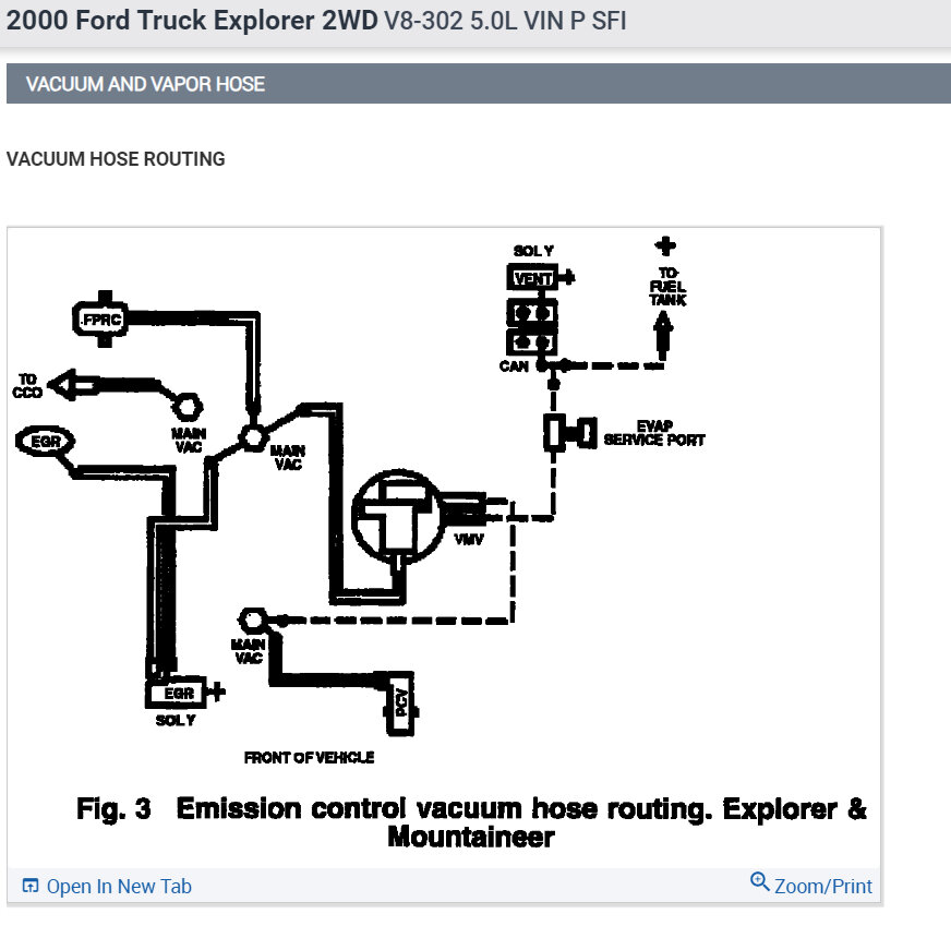

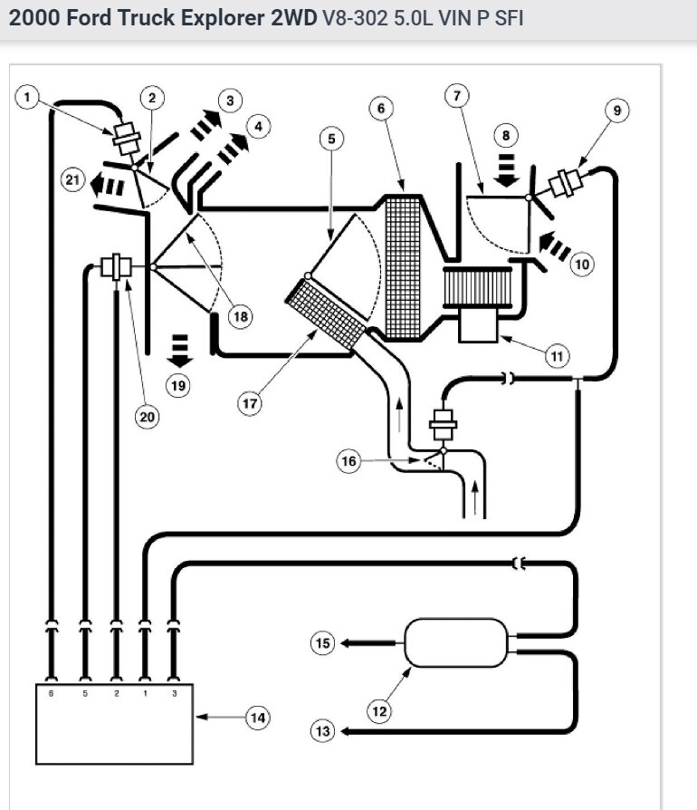

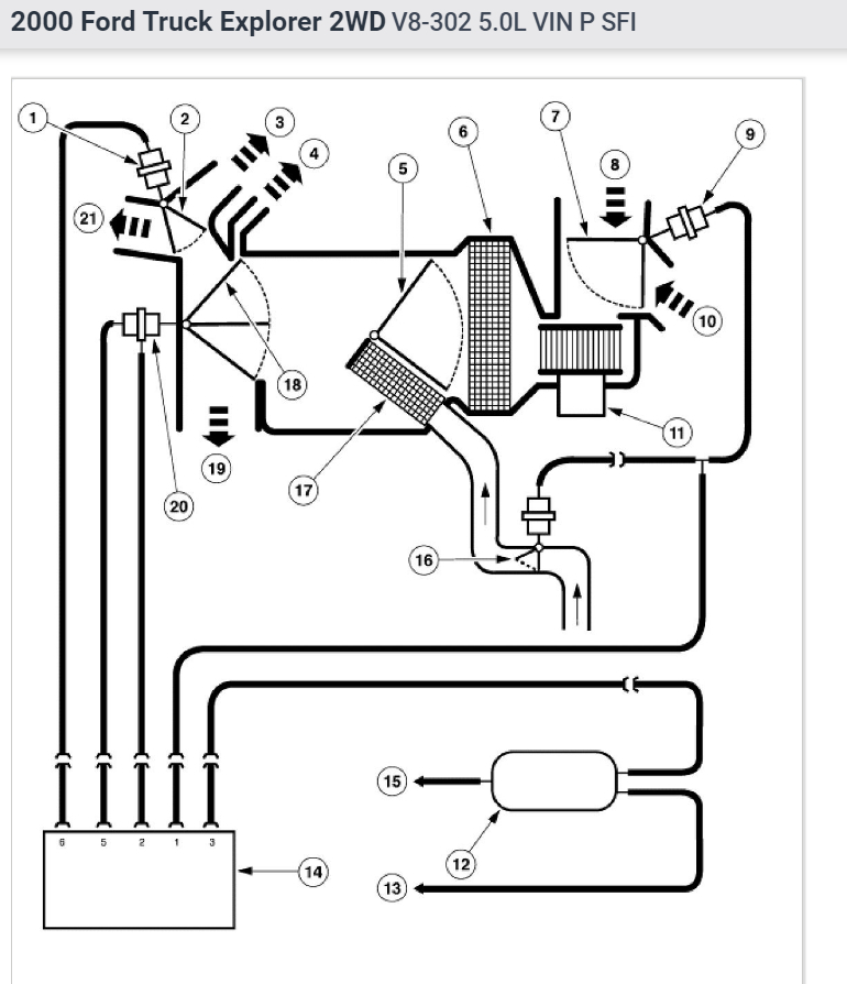

I am looking for a vacuum lines diagram to properly repair and replace multiple small brittle vacuum lines.

Yep, here are the engine and HVAC vacuum line diagrams as requested. Check out the images (below). Please let us know if you need anything else to get the problem fixed.

Thank you! I’ve had a hard time finding those.
