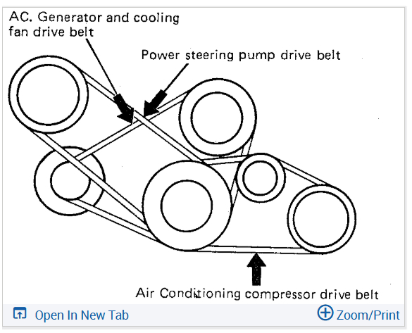

I have two broken or popped off belts. I need to know which belts they are and where the replacements go
May 8, 2026 at 3:32 PM
  • 55,402 POSTS
There are typically 2 or 3 accessory drive belts, depending on which engine and options the vehicle has (A/C, power steering, etc.). What size engine do you have? Here is the belt routing.
Alternator / Water Pump 4PK0960 (960 mm) Dayco 4PK0960, Gates K040378, Bando 4PK0960
Power Steering 4PK0925 (925 mm) Dayco 4PK0925, Gates K040364, Bando 4PK0925
A/C Compressor 4PK0805 (805 mm) Dayco 4PK0805, Gates K040317, Bando 4PK0805
Check out the images (below). Let me know if you need anything else.
