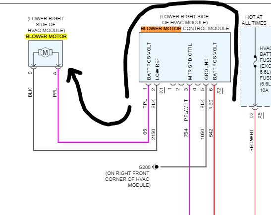

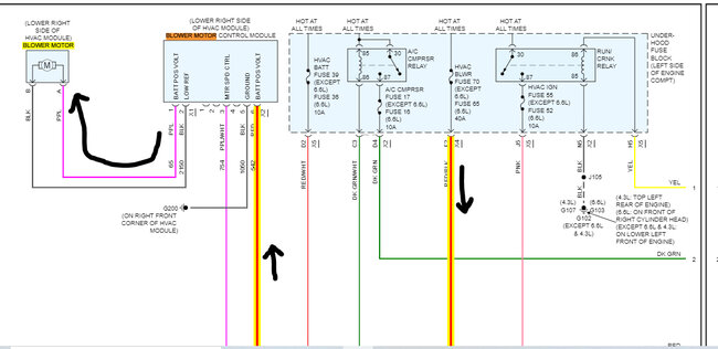

When the truck is off, and the keys are out, the climate control will turn on and the blower fan will run?
2011 CHEVROLET SILVERADO
111,000 MILES • 5.3L • V8 • 4WD • AUTOMATIC
NWENTZEL

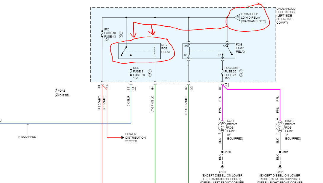

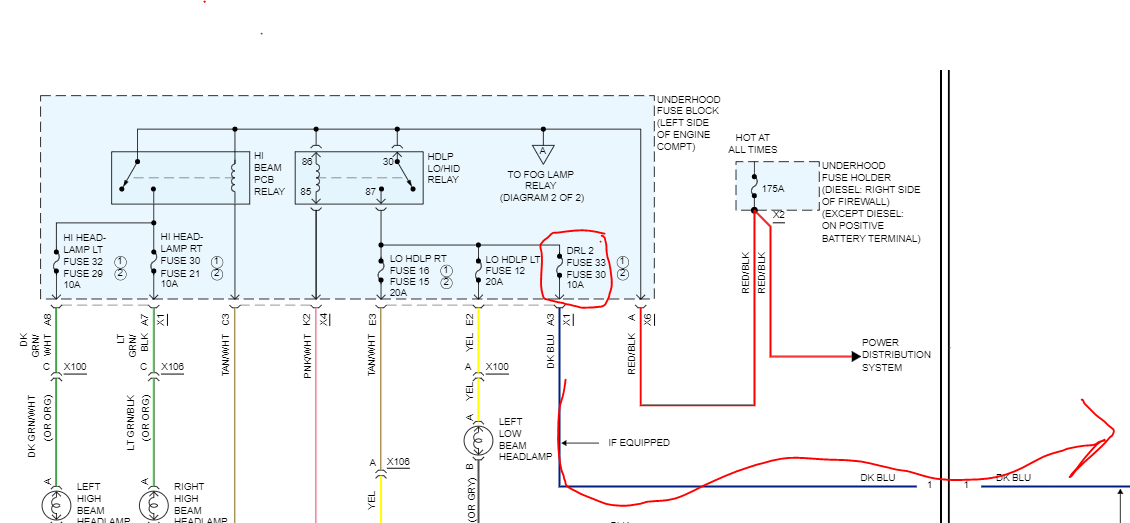

It seems to be worse with the colder weather. Also, maybe related or not my daytime running light are getting unswitched power at all times too. I have replaced the ignition switch thinking maybe it didn't recognize that the key was taken out.
Dec 6, 2022 at 11:37 AM
  • 110,240 POSTS
There could be an issue with a relay sticking. I need to know if the vehicle has automatic climate control or manual control.

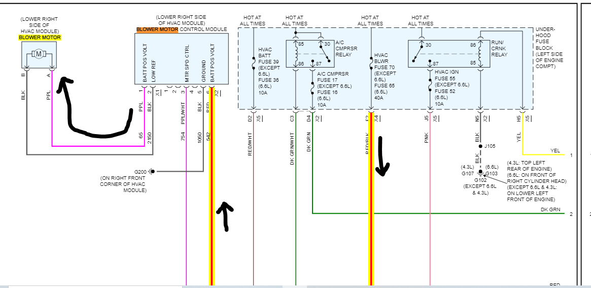

Pic 1 below is for the manual climate control. I need you to pull fuse 70 to confirm the fan stays off. If it does, then we need to check connectors and wiring for shorts to power between the fuse and the motor. Note, there is a blower motor control module. It too could have an internal short.

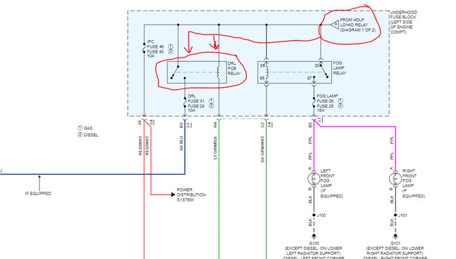

As far as the DRL, the last two pics are related to that issue. remove the DRL 2 fuse in the under-hood fuse box to see if the DRL turns off. It will be fuse 33. If it does, go to the DRL relay in the under-hood fuse box and switch it with a different one with the same part number to see if it fixes the light issue.
See pics below. If you have automatic climate control, let me know.
