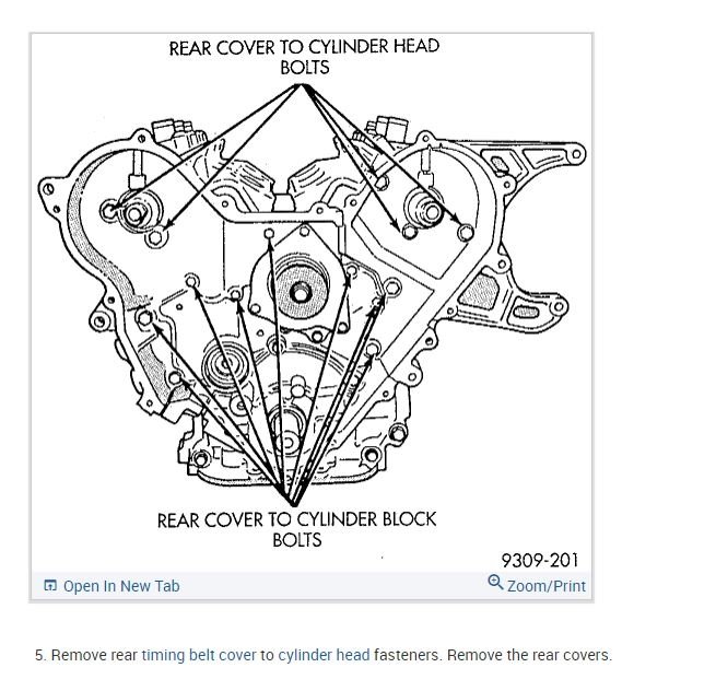

car has been overheating. replaced the main radiator hose, thermostat and the coolant reservoir cap which is pressurized. I have a sealed radiator. I'm not sure if I have a blown head gasket or not but want to try the sealer. How would I add that if I don't have access to the radiator. Can I pour it into the coolant reservoir tank?

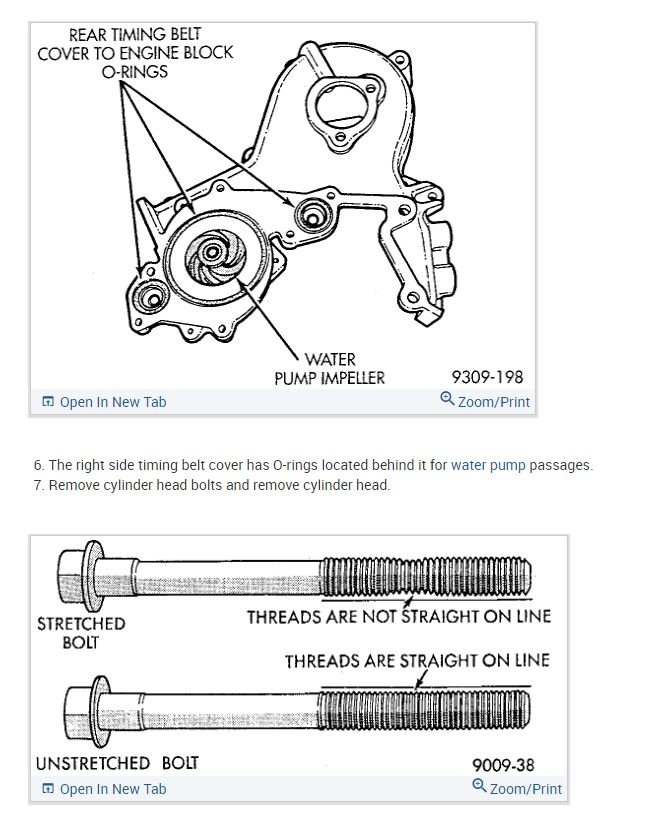

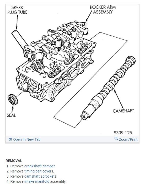

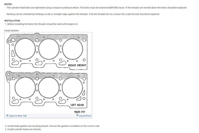

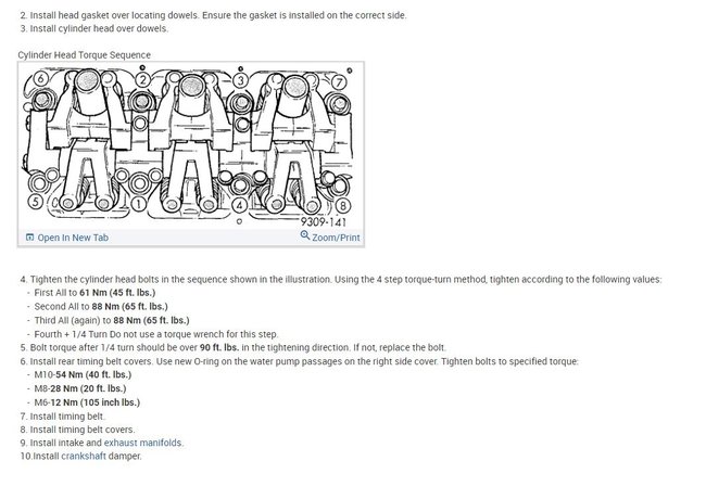

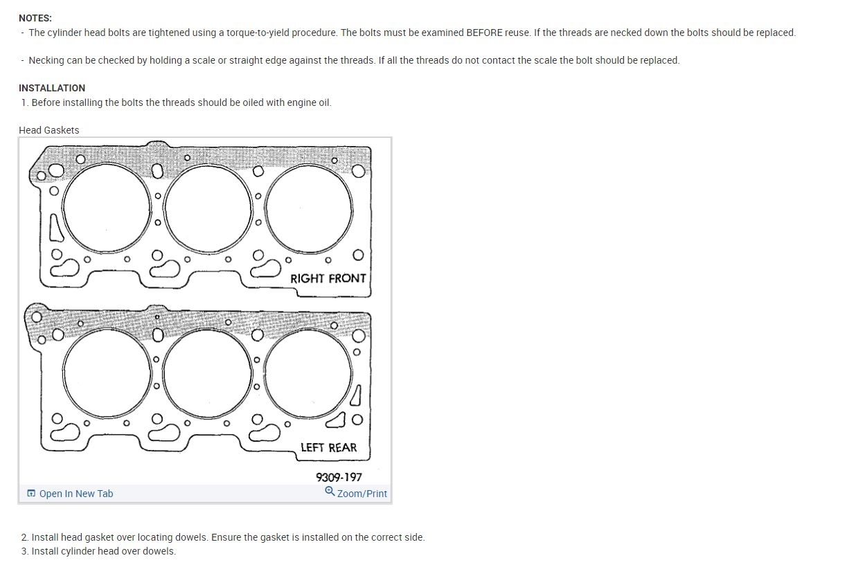

The correct way is to replace it. I attached the procedure below for you with some pictures.
