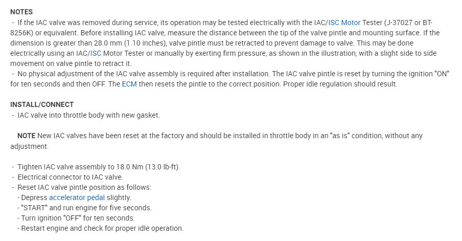

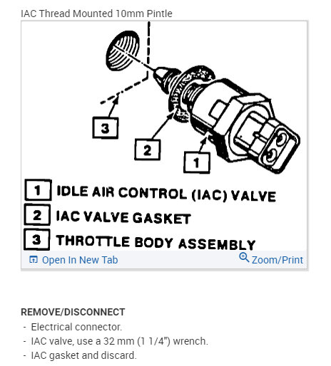

Did you place it directly into the throttle body? Were you using a product that was designed to be poured into the throttle body?
If that is how you installed it, there is a chance the air supply from the idle air control valve (IAC) was plugged with dirt or carbon.

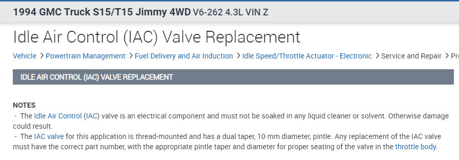

Remove the IAC and see if there is dirt inside where it mounts. Here is a link that explains how to service one. Note: It is located on the side of the throttle body. See pic 1 below.
https://www.2carpros.com/articles/idle-air-control-valve-service
I attached the directions below specific to this vehicle for the removal and installation of the IAC.
Let me know what you find.

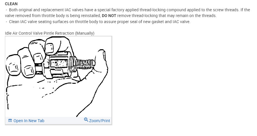

I removed the IAC, cleaned it and inside the intake where the IAC connects. I tried but couldn't move it manually spring tip pushing it didn't move at all like in the diagram you sent me.

If you couldn't move the pintel, there is a good chance the IAC is frozen. If it doesn't retract a little, it will starve the engine of air when you take your foot off the throttle.
Let me know if that takes care of the issue.

We removed the IAC that we think might be the problem plugged it in an started the engine the pinter shot out of the IAC? Put it back in just turning the key on an off several times the pintel slowly moved back in hooked the IAC back to the intake still shut off in drive? Waiting on the new IAC on Thursday.

If it runs okay off idle, I don't think it's the injectors. The pintel should have only moved a small amount. How far did it move?
