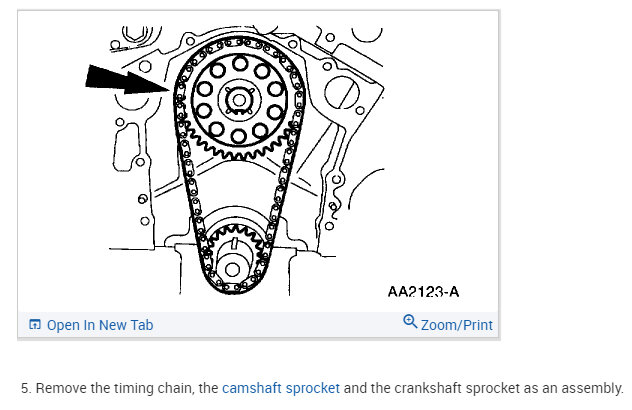

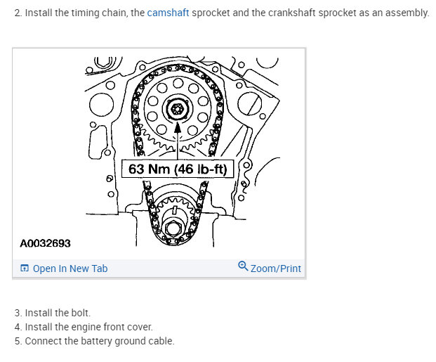

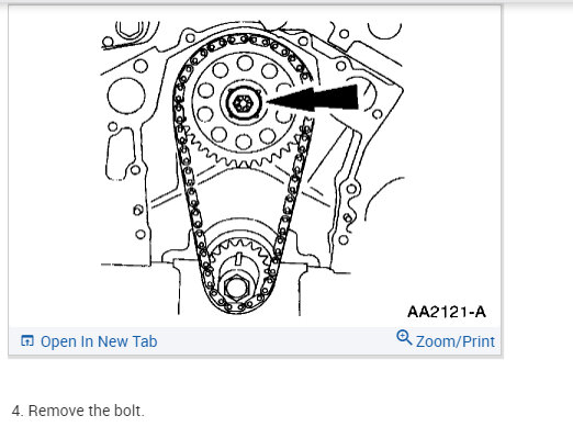

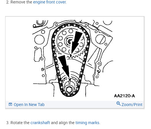

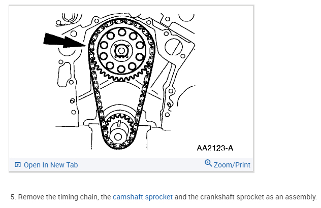

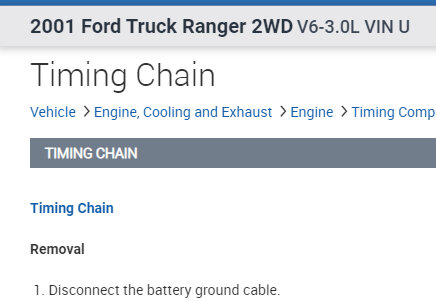

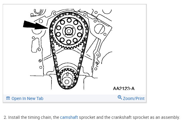

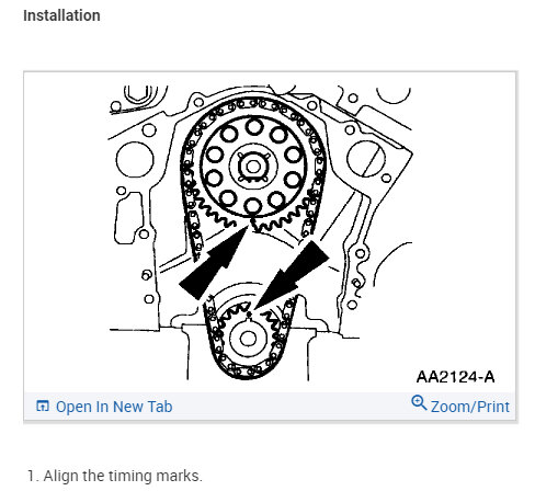

The only thing I would do is check for any oil leaks and replace gaskets as needed. If the engine was properly maintained and not abused, then I would leave the timing alone. If the oil was neglected or if the engine was abused, then I would replace the timing components.
I attached the directions below for replacing the timing chain. Take a look at the directions and let me know if you are comfortable performing them.
Let me know if this helps or if you have questions.
