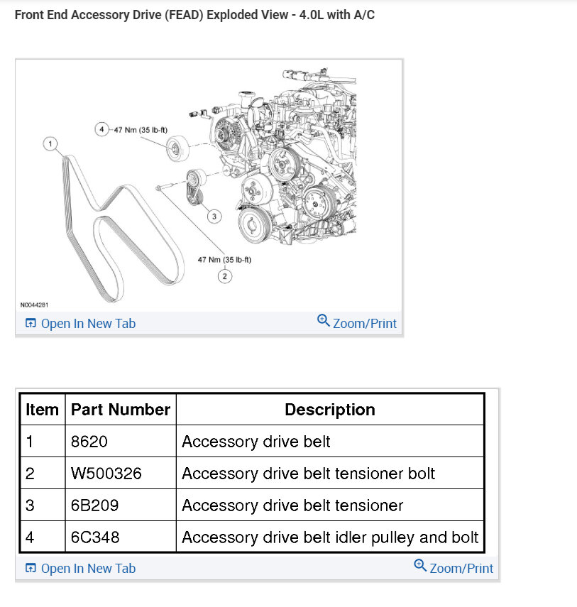

Hi, is it okay to use Belt Dressing on a Serpentine Belt such as the truck listed above uses? I need to clean this belt as some Power Steering Fluid accidentally spilled on it. I see a lot of controversy over using Belt Dressing on the internet and at Parts Stores! Thank you!
Jan 9, 2023 at 1:37 AM
  • 55,224 POSTS

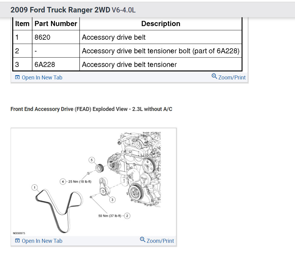

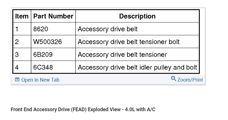

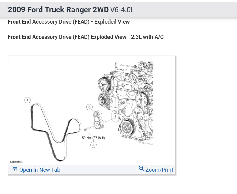

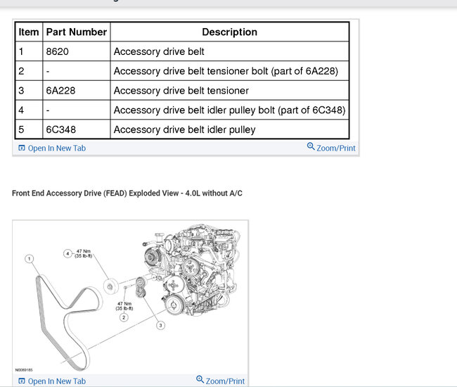

Yep, don't use belt dressing because it just masks the problem. you need to replace the serpentine belt and maybe the belt tensioner, I would do the belt fist.
here is a generic guide to help and instructions below to help you with your car:
Check out the images (below). Let us know what happens and please upload pictures or videos of the problem.

Thanks Ken, this is very helpful! I appreciate the diagrams and your advice!
