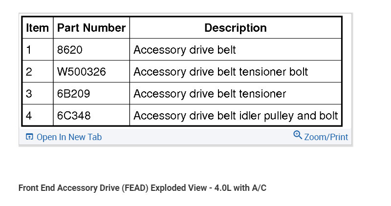

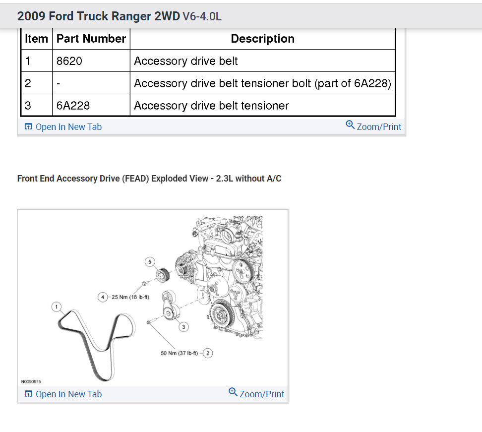

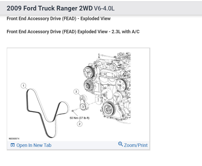

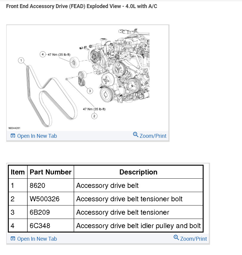

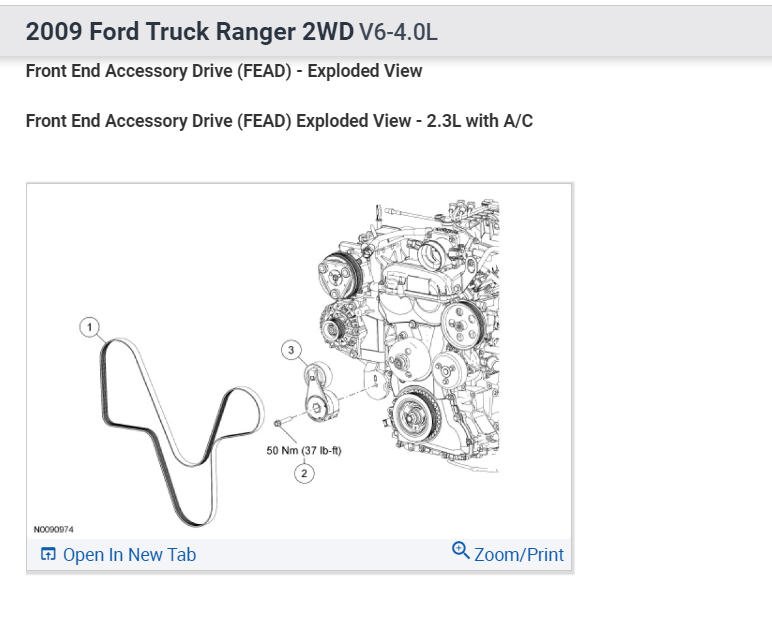

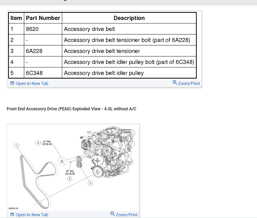

Yep, don't use belt dressing because it just masks the problem. you need to replace the serpentine belt and maybe the belt tensioner, I would do the belt fist.
here is a generic guide to help and instructions below to help you with your car:
Check out the images (below). Let us know what happens and please upload pictures or videos of the problem.
