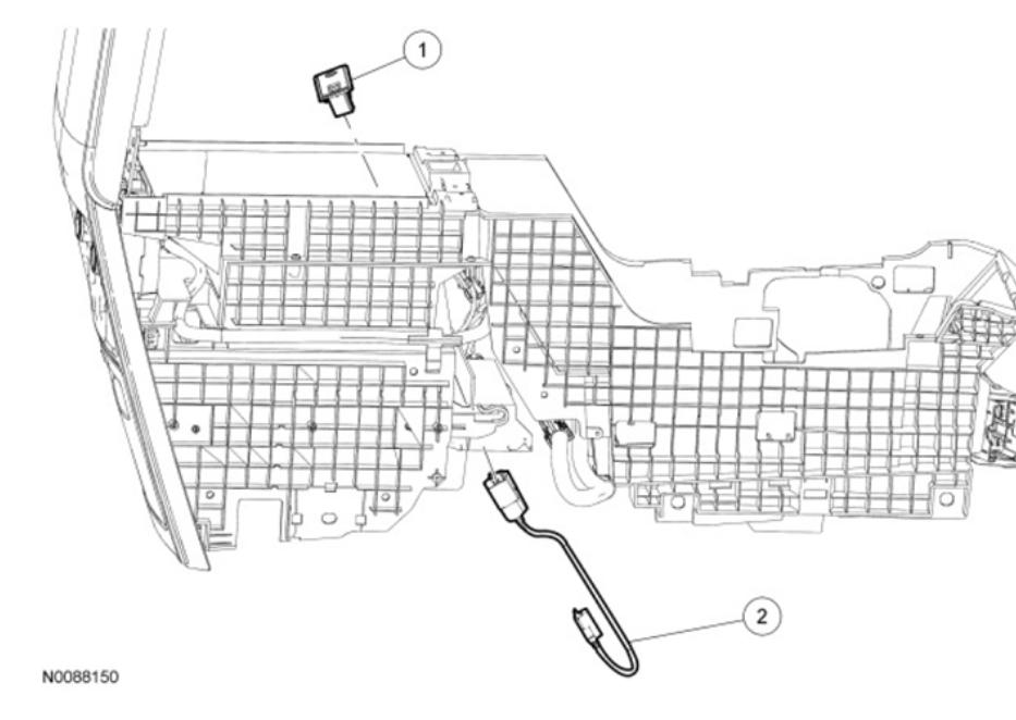

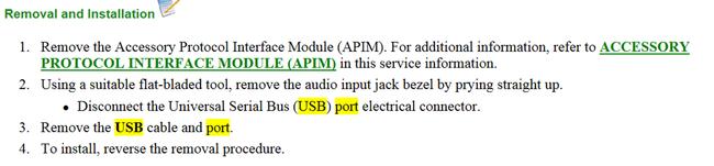

USB port pushed in center concel
2011 FORD FLEX
MWATTERSON
  • 40 POSTS
The USB port for the sinc system in pushed into the center concel. What is the be way to fix it.
I need help Just bought car.
Sep 26, 2014 at 6:13 AM
HMAC300
  • 48,601 POSTS
you may need to do what pics say and replace it as the clip may be broken.
