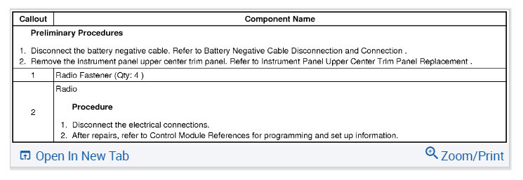

Recently my USB port and cigarette lighter/charger port stopped working. So, I found the fuse for the lighter/charger port and changed it. Once I did it started working but the USB port still isn't working. Can someone please tell me what I need to do to get the USB port to start back to working?

Is there a fuse that goes to the USB port?

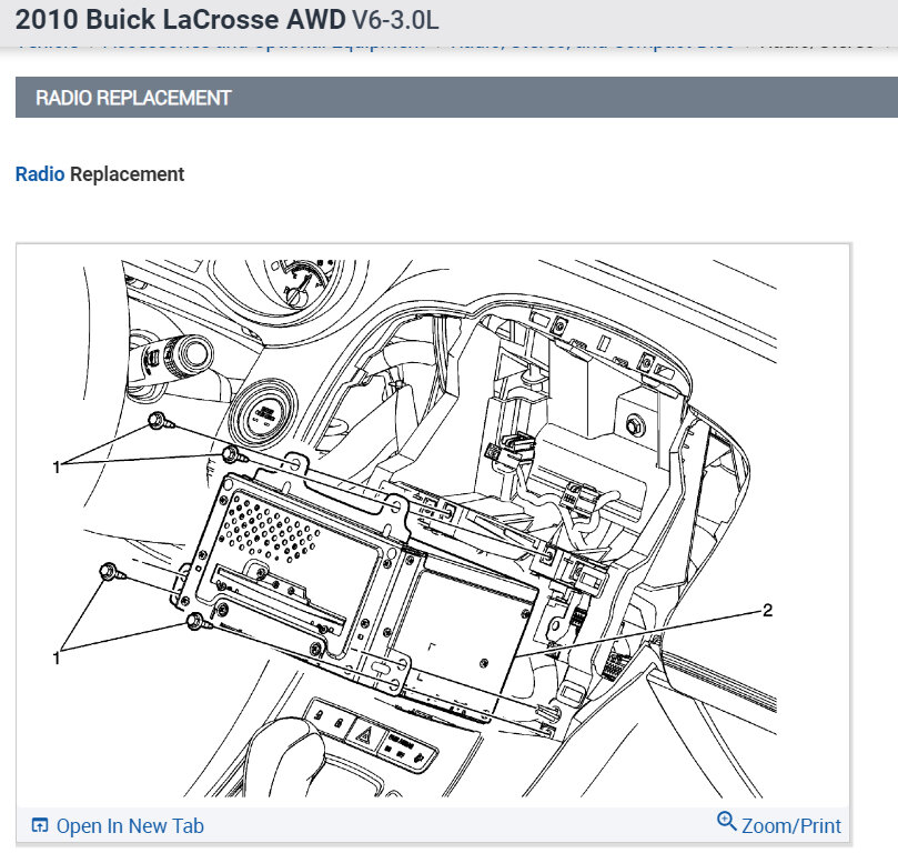

It is fused through the radio, does the radio work?

Yes, the radio is working but when I press auxiliary it's not doing anything.

The problem sounds like it is the radio itself. Here is how to change it out and get a rebuilt unit. Check out the images (below). Please let us know what happens.
