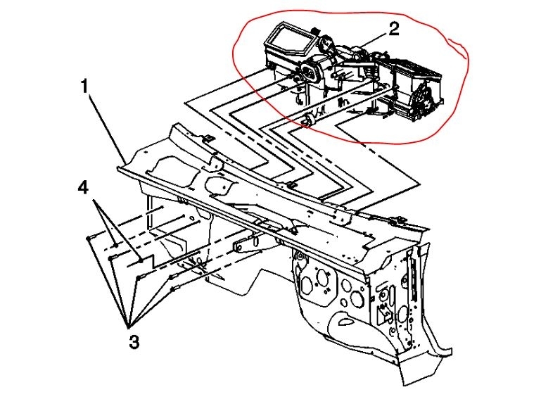

Wow. That is an issue.
It is now in all the ducts which will require removing the heater box to access all the ducts. They will have to be treated to get rid of the smell.
There is no spray to work externally to get rid of that smell. This will require the removal of the dashboard to access the heater box and the ducts.

I agree. There are some sprays for the ducts you can get at a parts store but that smell gets embedded into the plastic and it is tough to get out.
To remove the housing, you are looking at about an 8-hour job at a shop.

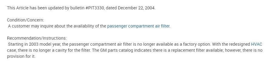

I have Googled. Would I need to clean the condenser coils, cabin filter, and/or throttle body? When I accelerate I get a whiff of stink.
Feb 21, 2020 at 4:59 AM
When I answered in the beginning, I thought it was under the hood. Now I know it is inside.
Condenser coils and throttle body are outside under the hood.
You need to clean the evaporator, heater core, and all the ducts. You can remove the cabin filter and try spraying some cleaners in that area.
I just attached the TSB for the filter. You do not have one. GM dropped that option in 2003.
