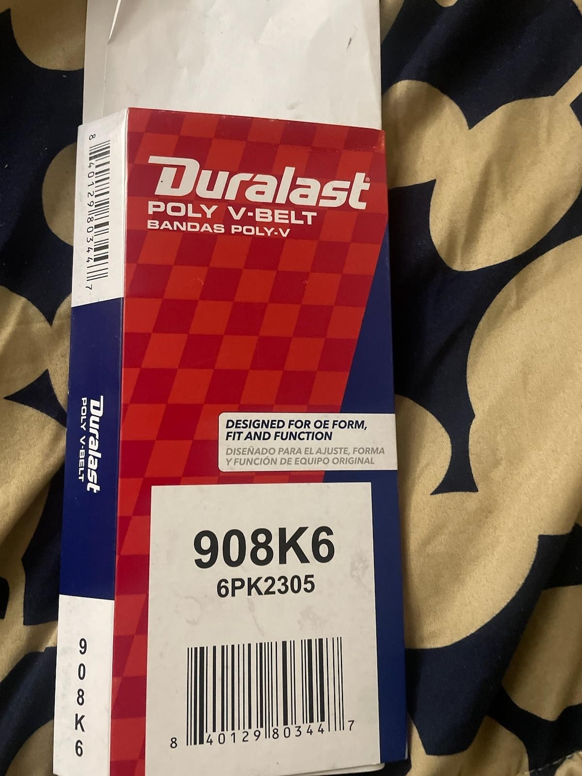

I deleted the A/C compressor this is the size belt needed for a 3.2 l V6 2003 Mercedes-Benz E320.
