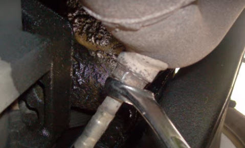

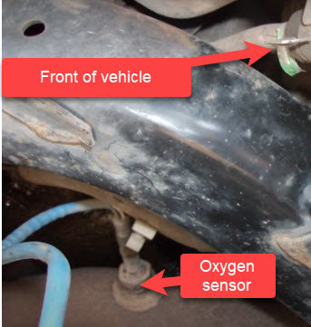

Hi, need your help, my red light comes up on my dashboard. According to the
Scanner, the code is P1131.
I would like to know where the upstream Bank 1 sensor is located.
If possible a diagram would be very helpful.
Thank you, Kenny
Jul 21, 2021 at 11:30 AM
BMDOUBLE
  • 1,139 POSTS
It is accessible from under the lower engine splash shield under the front of the vehicle.

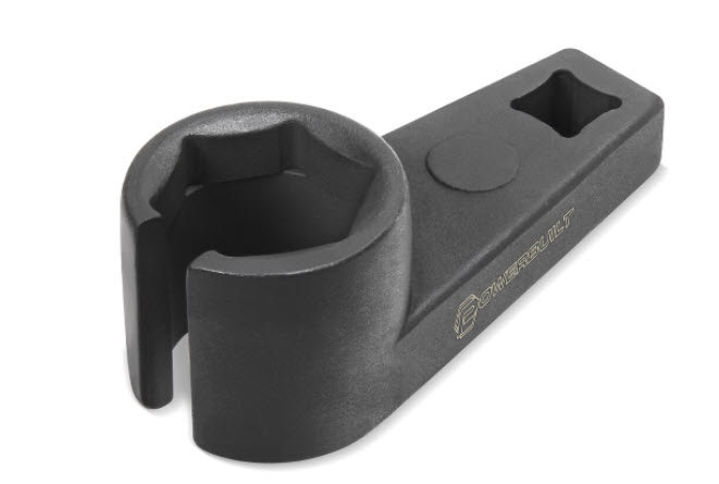

I have attached a picture that should help you locate it. You can either use a box end wrench after cutting off the old connector, or use the special tool that you can pick up at most parts stores.

Thank you, what you sent me is very helpful. Always appreciate your help and technical expertise!
