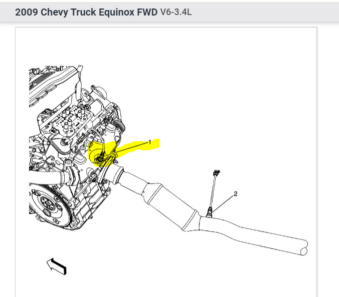

I need to know exactly where the upstream O2 sensor is located on my vehicle listed above and a diagram if available?

The upstream O2 sensor is at the rear of the engine and mounted on the exhaust manifold. I attached a pic below showing the location.
On this vehicle, there are two sensors, an upstream and a downstream. The downstream is after the catalytic converter and the upstream is before it.
take care,
See pic below.
