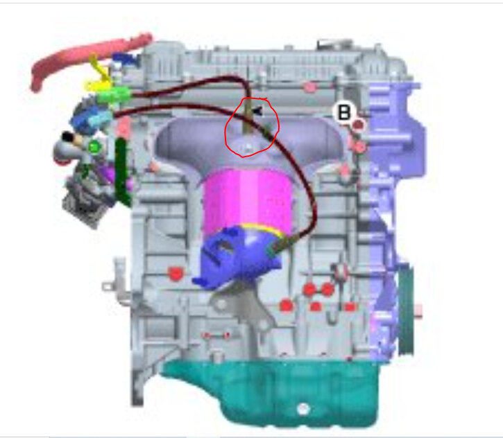

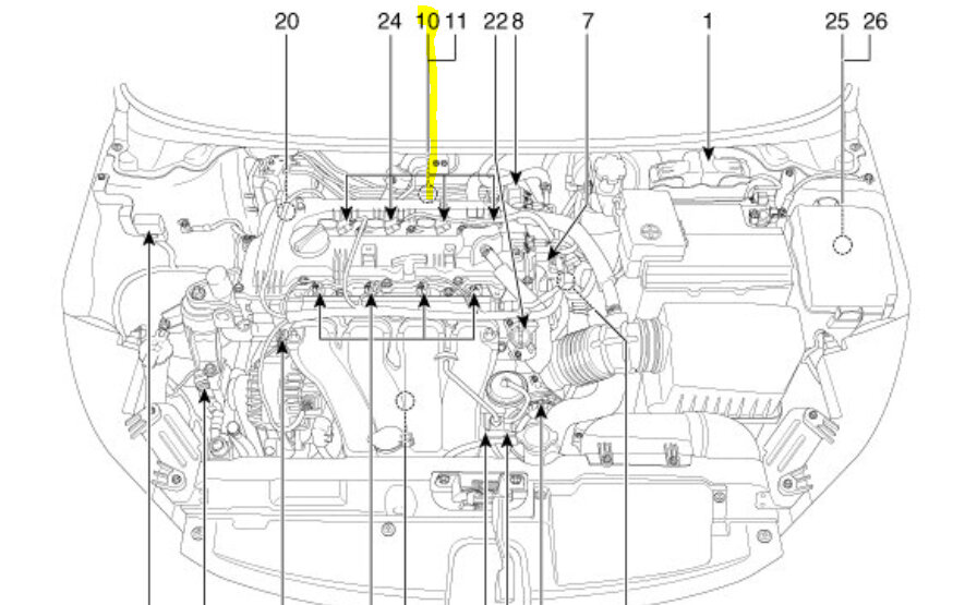

My car is throwing two codes P0030 and P0135:
"O2 Sensor Heater - Heater Control Circuit (Bank 1 / Sensor 1)"
Sounds like I will need to replace my upstream oxygen sensor. The problem is I don't where the sensor is on this specific year/model.
Dec 15, 2022 at 10:05 AM
  • 110,244 POSTS

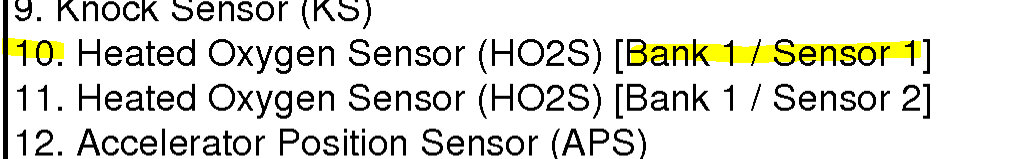

The upstream (Sensor 1) o2 sensor is in the exhaust manifold. If you take a look at pic 1, I highlighted where to look. Picture 2 just indicates that number 10 in the picture is bank 1 sensor 1.
The last pic shows a view from the back of the engine (against the firewall). I circled the sensor.
