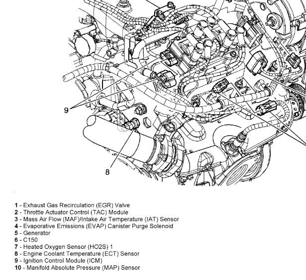

Where is it located?
Sep 22, 2020 at 11:06 PM
STEVE W.
  • 15,295 POSTS
It's in the middle of the rear exhaust manifold, between the firewall and the engine, just above the flange the exhaust system connects onto. Check out the diagrams (Below). Please let us know if you need anything else to get the problem fixed.

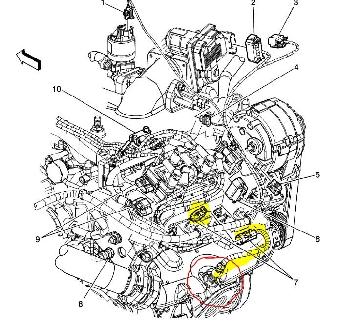

I have a engine light code that say P0053 bank 2 senser 1. Where is this located at? Can I see a picture where it is at and how many oxygen sensors does my car have?
Jan 4, 2021 at 1:07 AM (Merged)
Good morning.
I attached a picture for you to view. That is the sensor in question.
The sensor is one of many possibilities for this code. Below are the possibilities.
P0053
Descriptor
Engine Controls
Probable Causes
Heated Oxygen Sensor (HO2S) 1 Fuse Open
Heated Oxygen Sensor (HO2S) 1 and 2 Heater Low Control Circuits Open or High Resistance
Heated Oxygen Sensor (HO2S) 1 and 2 Ignition 1 Voltage Circuits Short to Ground
Heated Oxygen Sensor (HO2S) 1 and 2 Intermittent Condition or Poor Connection
Heated Oxygen Sensor (HO2S) 1 or 2
Powertrain Control Module (PCM)
Powertrain Control Module (PCM) Intermittent Condition or Poor Connection
