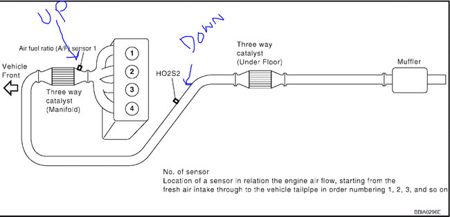

On my car listed above I have 2 O2 sensors, 1 is located by my radiator (like you can see it when u pop the hood). The second is located under the car where the catalytic converter is. My question is, which 1 is upstream and which 1 is downstream?

The terms upstream and downstream simply refer to the location of the catalytic converter and where the sensors sit in relationship to it.
Upstream means before or above the converter. Downstream means below or after. In this case, the downstream will be slightly ahead of the catalytic converter under the vehicle.
I attached a pic below. Sorry for the sloppy writing. I hope that helps.
https://www.2carpros.com/articles/how-to-replace-an-oxygen-sensor
See pic below.
