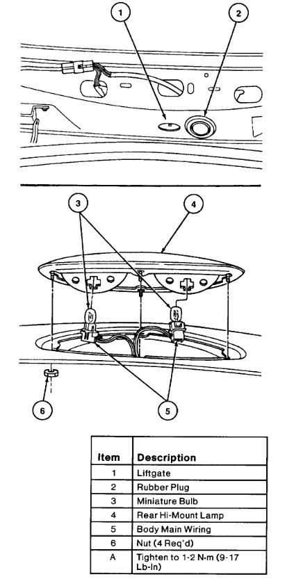

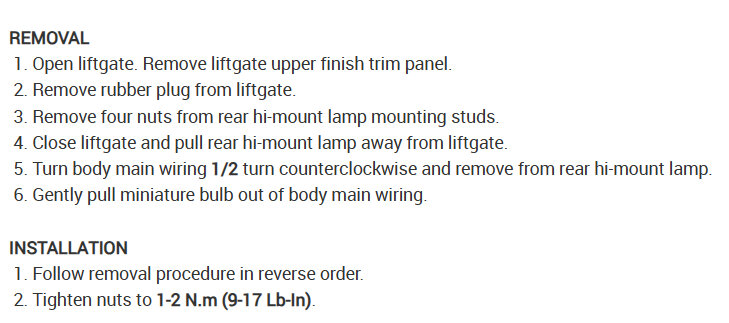

Need instruction on how to replace complete assembly of upper rear brake lamp assembly. The vehicle listed above is a Taurus Wagon.

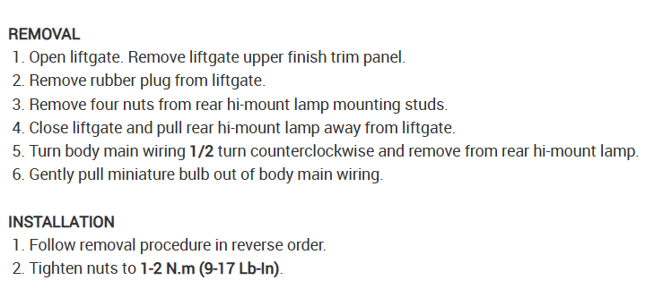

Yep, there are mounting nuts that need to be removed from inside the car. here are the instructions on ow to change out the brake lamp and housing as requested. Check out the images (below). Let us know if you need anything else.
