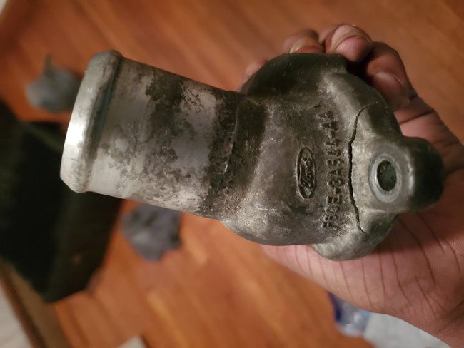

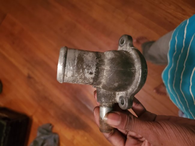

I need to replace this part for my car listed above. Very beautiful and reliable classic. But I'm not sure if this is the upper or lower thermostat housing. So here's a picture of it. Starting to realize it's becoming hard to look for online and the Ford/Lincoln dealership discontinued this part. But I heard Napa may have it in stock while my last resort is pulling this part off a 1999 Continental from a junkyard. My question is that, does anybody know where exactly can I search this particular part?

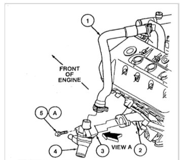

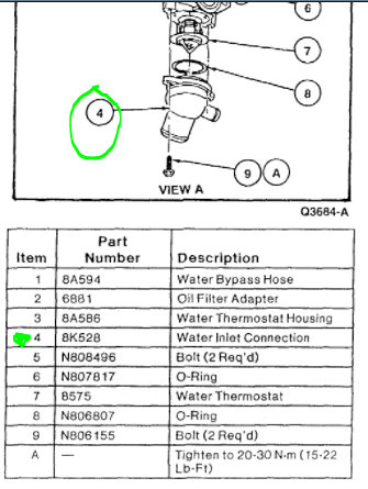

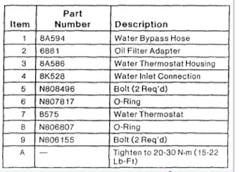

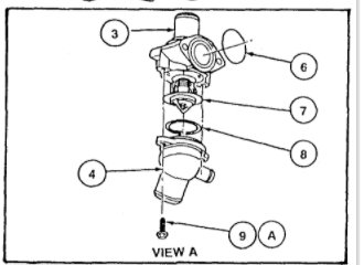

That photo is of the thermostat water inlet connection. I've attached pictures below. It mounts to the thermostat water inlet housing. I'll try to get you a part number today. Hope this helps and thanks for using 2CarPros.
Monday, August 23rd, 2021 AT 4:38 AM
DANNY L
  • 5,648 POSTS
Hello again.
I did confirm that part is discontinued. I tried getting a part number from Ford but to no avail. Your best bet is to find a used one from a pick-a-part type yard or auto wrecking yard. You mentioned find one from a 1999 Continental and that will work. Most Lincoln Continentals with the 4.6 liter engine should work. Hope this helps and thanks again for using 2CarPros.
