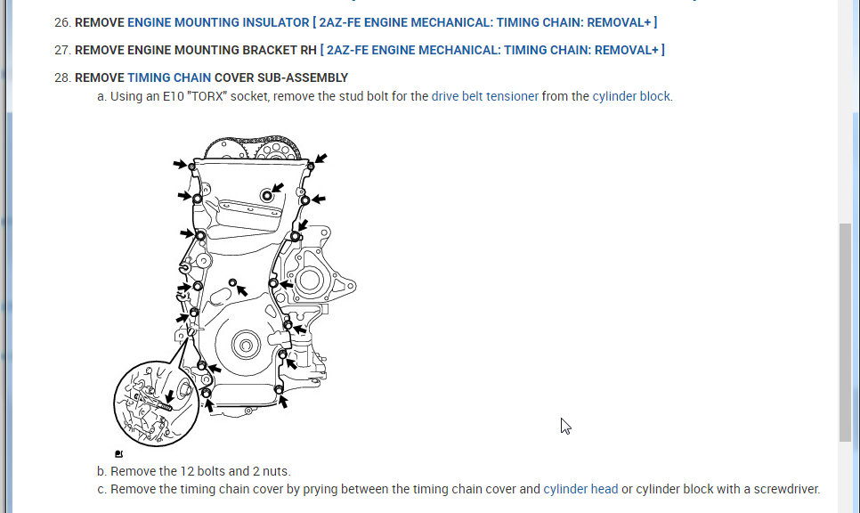

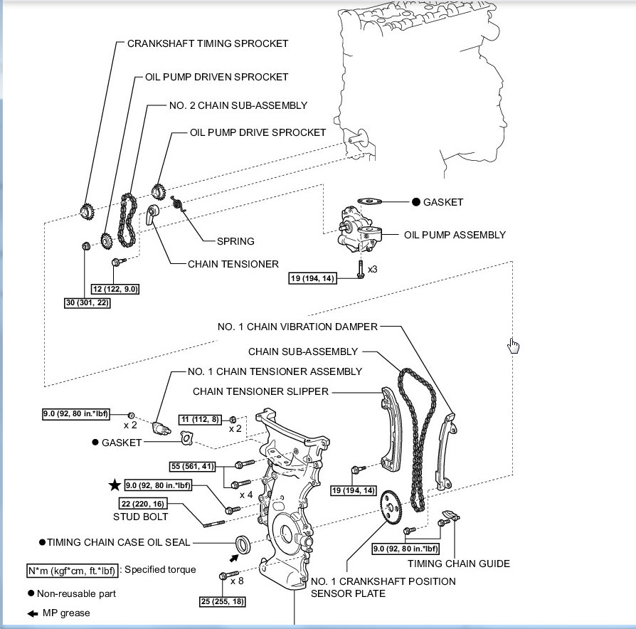

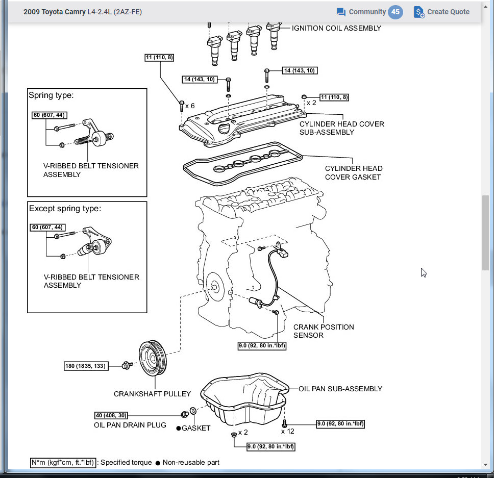

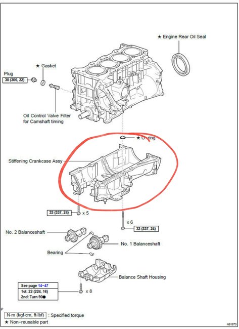

Can you take a look at this exploded view and let me know what you are referring too when you say upper oil pan?

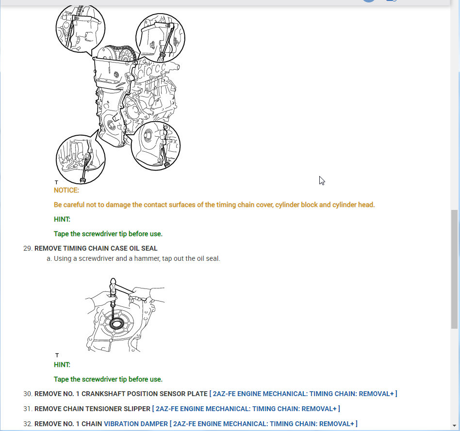

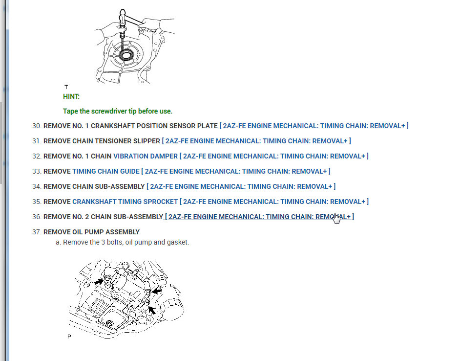

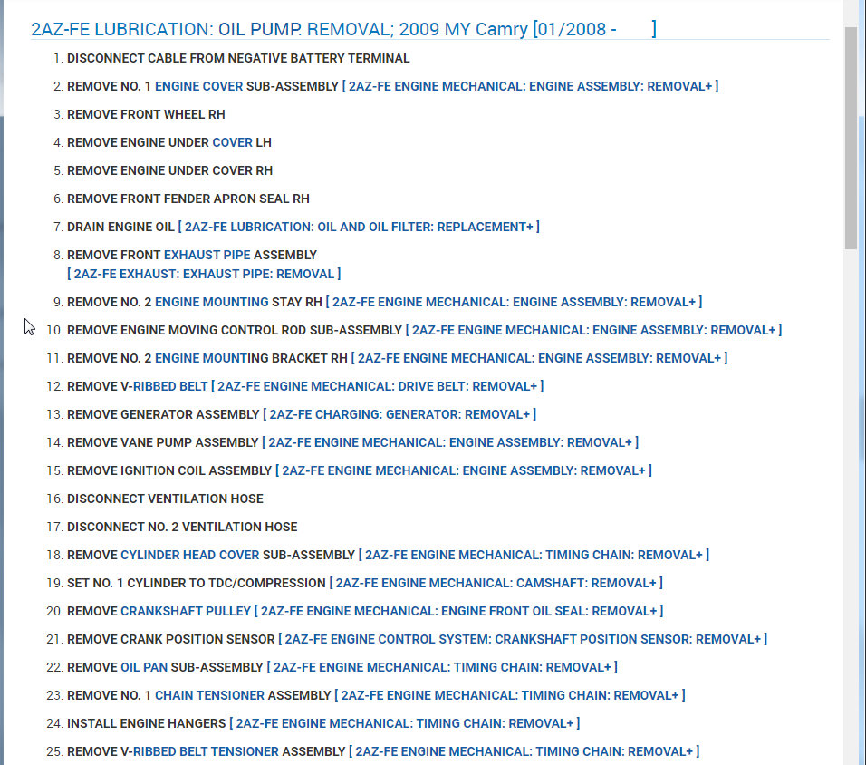

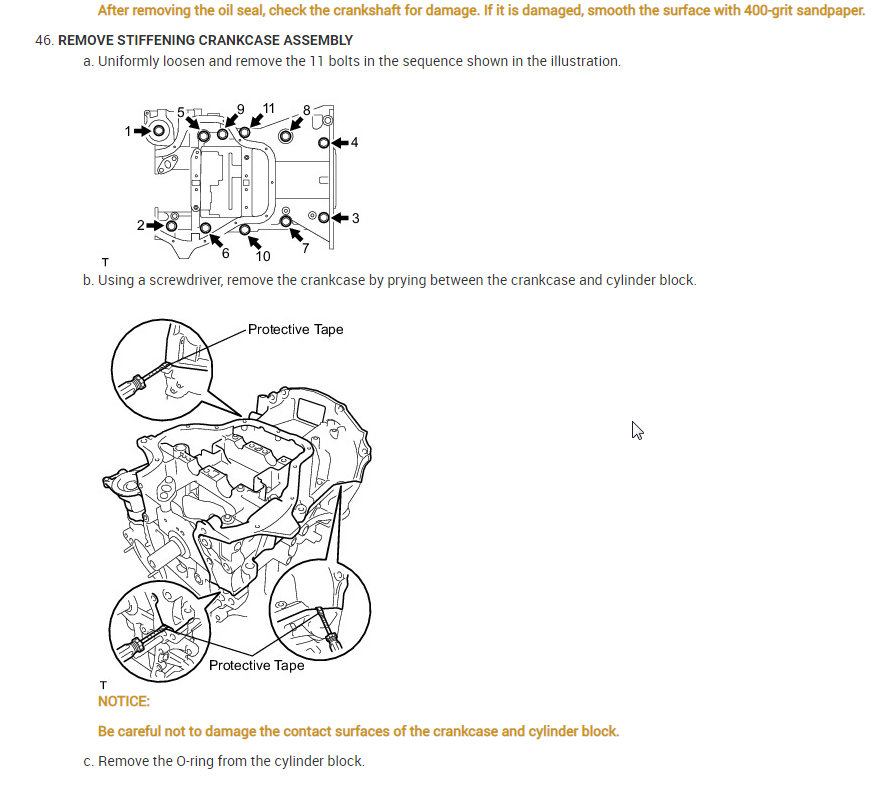

I included the process from the manual on how to remove the oil pump which appears it can be done while in the vehicle because it does not tell you to remove the engine. This means, I suspect you can do the oil pan in the vehicle. I have never done this on this specific engine but you can normally do this on these engines in the vehicle. Let us know what other info that you need. Thanks

Sometimes it's listed as upper oil pan, here it is listed as stiffening or crankcase assy.
Jan 17, 2021 at 6:20 AM
Oh. Got it. I have only ever done those with the engine on an engine stand. The manual will not list it in any other section then the disassembly portion. So unfortunately it looks like it will need to come back out. I looked online to see if there were any videos of anyone doing this in the vehicle and I could only find it shown on people rebuilding the engine. Sorry.
