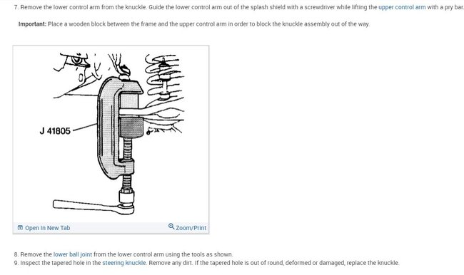

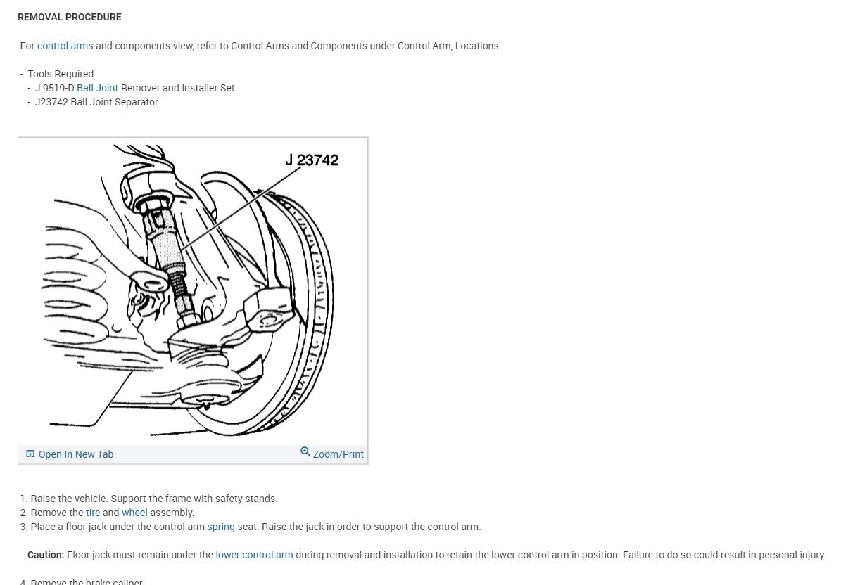

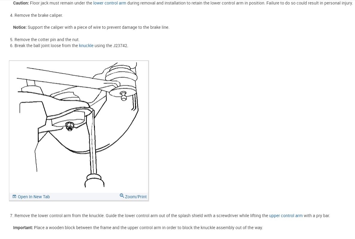

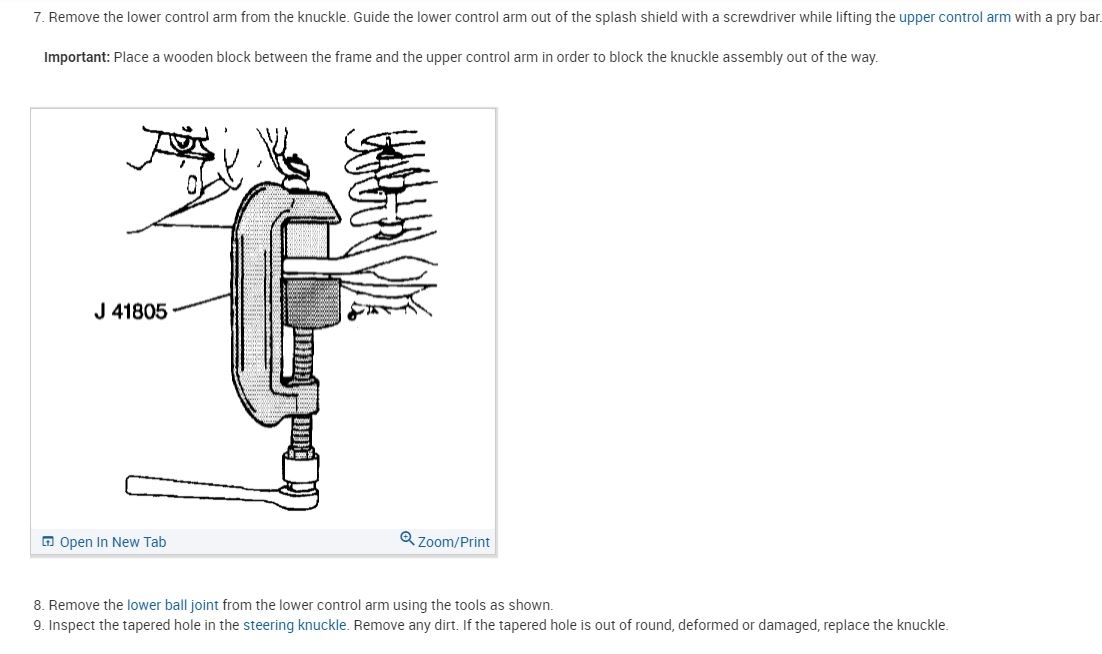

Loaned truck out and was basically super dogging it and caused the ball joint to break on one side. I cannot afford another day down. Can I just change upper and lower ball joints on one side since other is not broken go back to it Saturday next weekend?
Nov 10, 2018 at 11:33 PM
Good morning,
Yes, you can do just one if you like. There is no reason to change them all when 1 fails.
The ball joint failed from impact. Sounds like a pothole or a raised street level that caused it.
https://www.2carpros.com/articles/how-to-release-a-ball-joint
